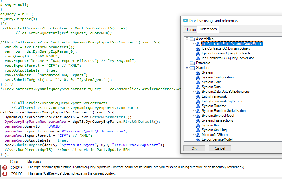

I recreated this in a ShipHead DD Standard directive but getting error when I check it
The type or namespace name ‘DynamicQueryExportSvcContract’ could not be found (are you missing a using directive or an assembly reference?)
The name ‘CallService’ does not exist in the current context

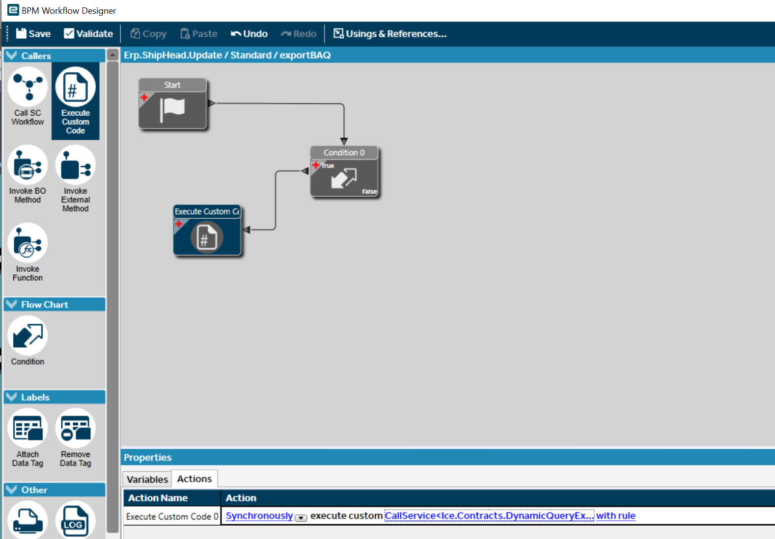

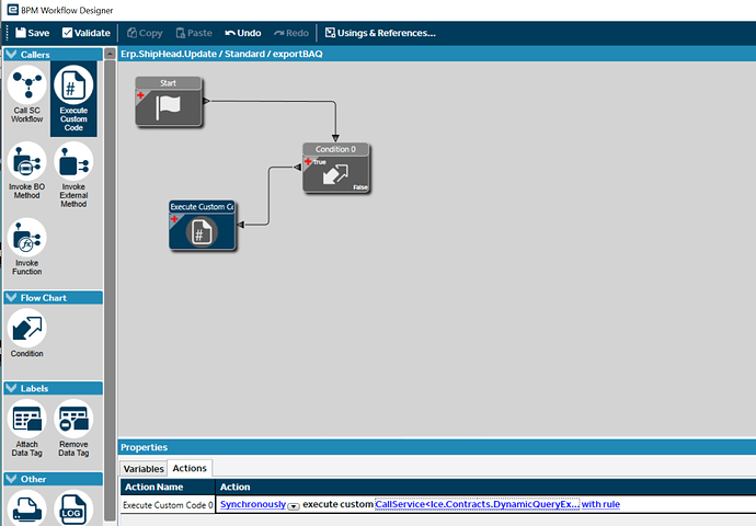

I’m wanting to export BAQ using a BPM as well. Look at your screen where did the Execute Custom option come from? Can I see the command you have in yours?
Shanna Frank
Top left, right next to “Call SC Workflow”
Thanks, I just figured it out too. It’s under method directive, I was in Data Directive. I’m new to the BPM world. Thank you for answering.
This should be a data directive. I screencapped Data Directive Maintenance.

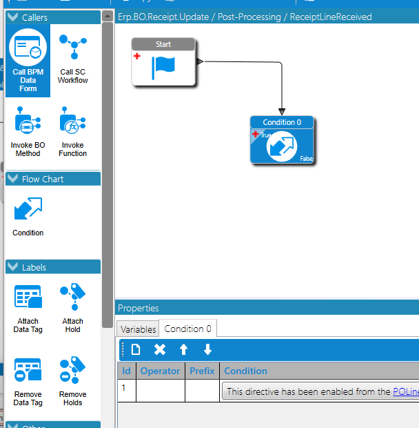

I have another quick question. The Execute custom code was on my screen earlier today and now it’s not showing. Would you why?
Hmm I’m really not sure. Does your user account have the “BPM Advanced User” option selected?
