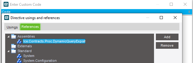

I found this in the References->Add Assemblies:
But not sure how to invoke.

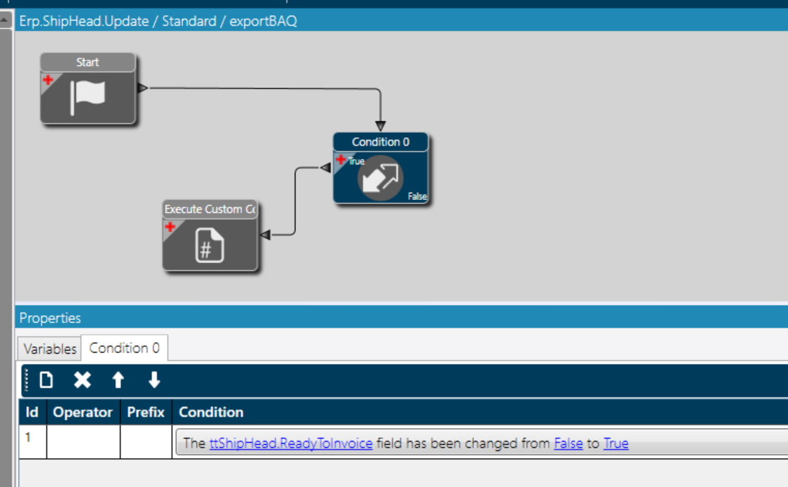

Done, works, gimme a minute to post.
You could do a standard Data Directive on ShipHead:
(ReadyToInvoice is the “Shipped” checkbox on Customer Shipment Entry)
In the custom code widget, you can call the Export with:
CallService<Ice.Contracts.DynamicQueryExportSvcContract>( svc => {
  var ds = svc.GetNewParameters();
  var row = ds.DynQueryExpParam[0];
  row.QueryID = "BAQ_NAME";
  row.ExportFilename = "Baq_Export_File.csv"; // "My_BAQ.xml";
  row.ExportFormat = "CSV"; // "XML";
  row.OutputLabels = true;
  row.TaskNote = "Automated BAQ Export";
  svc.SubmitToAgent( ds, "", 0, 0, "SystemAgent" );
