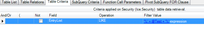

You can use an expression with a parameter
select
	[Security].[SecCode] as [Security_SecCode]
from Ice.Security as Security
 where (Security.EntryList like '%' + @Test + '%')
Thank you that worked!
