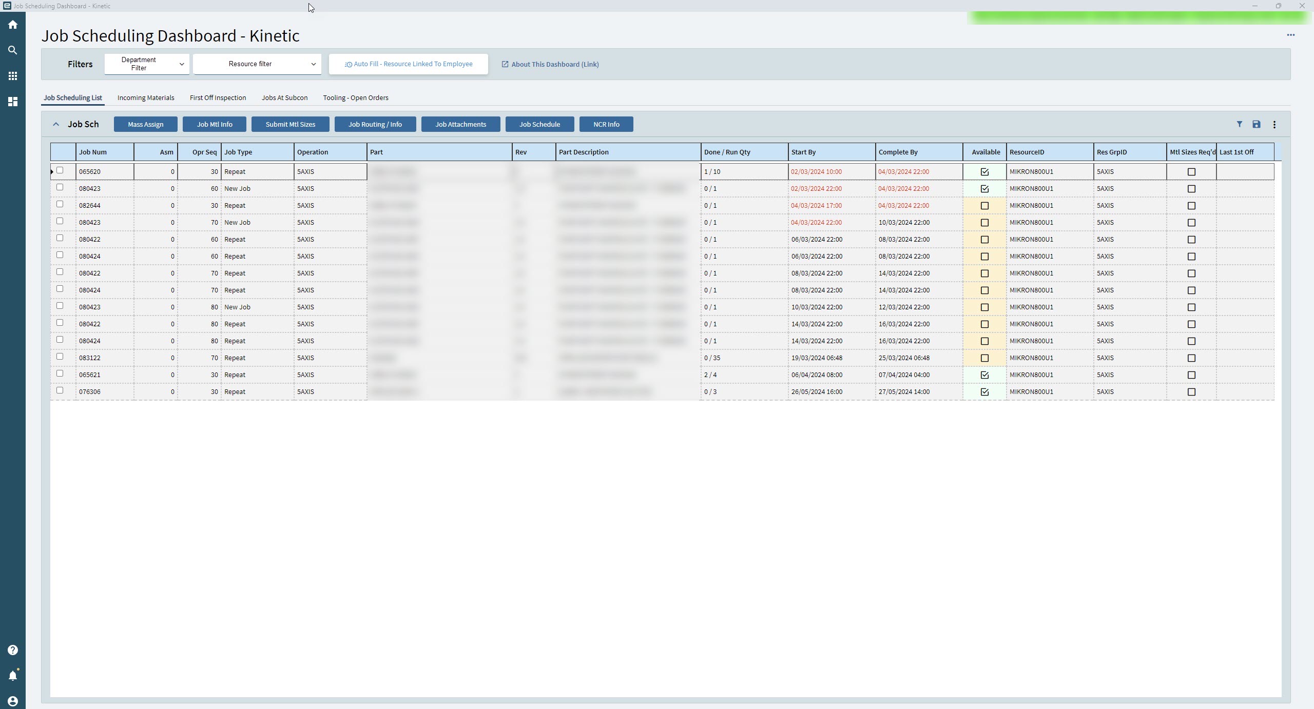

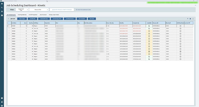

Hopefully this helps in terms of a visualisation, we redeveloped our E10 dashboard when upgrading to Kinetic.

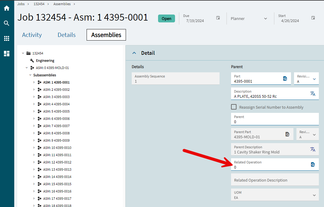

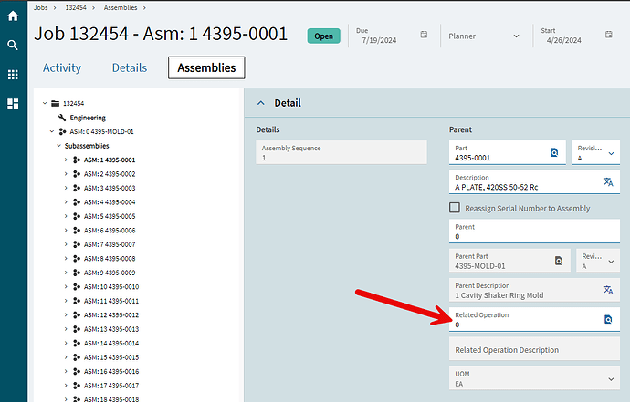

There is a related operation field on the job assembly. Try entering op 20 as the related operation on your assemblies. If the related operation on your assemblies is 0, Epicor’s scheduling logic assumes the subassembly can be started right away, but you want to start with Asm 0 op 10, then work on the subassemblies, then Asm 0 op 20. I believe with the related operation set to 20, Epicor would see that the assemblies need to be finished before op 20 can start. You could see if it reflects that way in the Epicor schedule, and then if so, you could use Work Queue or build that logic into your dashboard.
