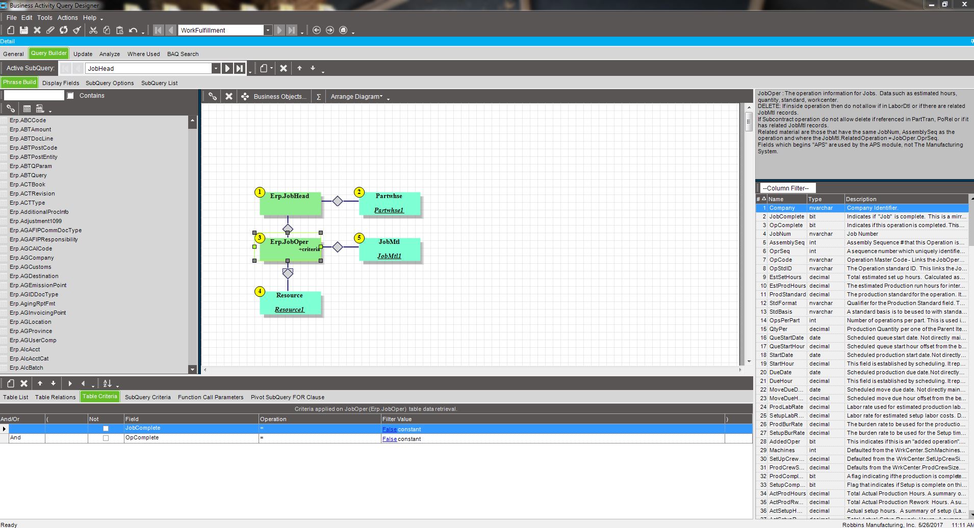

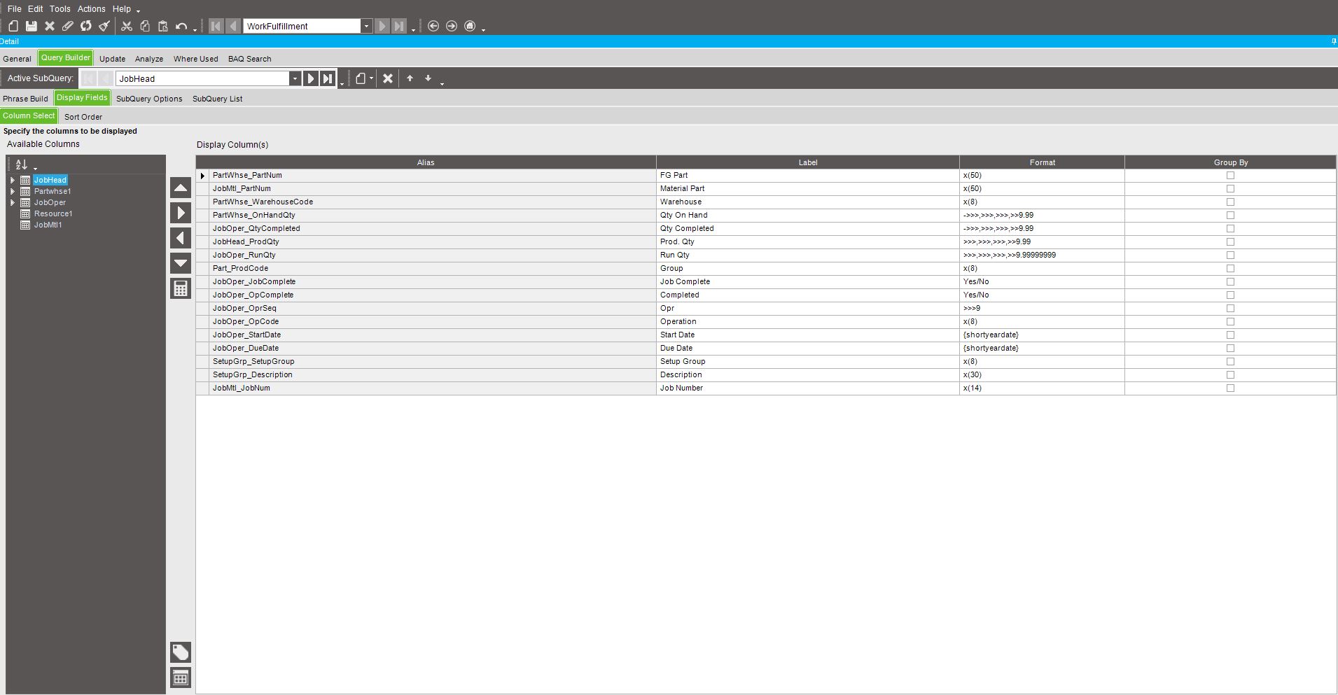

Hey every, I’m Trying to write a BAQ where only the first operation that is open, is what is displayed. The BAQ is designed to show us what we need and where it’s at. The problem is it will still show me where it will be going after where it’s at. I don’t need this information. Only the current uncompleted operation. Anyone have any ideas?
This is a huge deal to our company, and have been working and researching it for over 2 weeks. is there no way to do this?
What does your BAQ look like?
My boss wants to see everything on one list from FG part to sub components. so I’ve had to use Sub queries to reduce the amount of repeated lines.
So far, this is working perfectly. The only trouble I am having is it will show me all open operations, I just need the first open operation.
Thank you very much.
So after looking into some sql, I believe I came up with a solution to this, by using the distinct keyword in the subquery options tab. The description of distinct says that it specifies that only unique rows can display In the result set. so if I sort by job num, and job op seq, I thought I would get my required result. the first open op. being im not showing only closed ops. Does anyone know how to use this feature? and is there a way to change it in the code? seems like I cannot edit the code. even in developer mode and with a lot of privileges.

Ive have also been curious if I could use the min() on Joboper.oprseq in a subquery that would get the result im looking for.
Try using a calculated field min() job op and op description
so I did a calculated field with min(joboper.operseq), group by joboper.jobnum. linked it to joboper in my top level with a inner join. and no luck. ill continue to play with this, but its also very necessary to sort by job number and oper seq to be able to pull the lowest number seq of a job. cant sort when doing a group by with the calculated field. Im going to shrink up this BAQ and try to get it to work with a lot less and slowly build up from there. see if I can get anywhere.
Trevor - I’m working on something similar, and narrowed it down to a top level and subquery, both with only the JobOper table, which filters out completed jobs and operations, then does either a min calculated field to show the smallest sequence number, or TOP row 1 to show the first row of the subquery.
Been trying using Top for the Result Set Rows on the Subquery (Subquery Option Tab). It worked at one point, then I changed it attempting to make progress elsewhere, and now it’s spitting out an error when I analyze the BAQ.
I tried adding a calculated field on the subquery for min(JobOper.JobOprSeq), and have issues now, but I believe it worked as well.

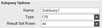

Do a CTE query on the joboper table. Make every field in it a group by except for operseq, which you want to do as a min. This will get you to the current record. You can then use the CTE query in another query to do anything else you want.
Any way you could show me an example. I have done what you said and not getting the result I need. all operations still show up. I would like all operations after the first open operation to not even appear.
I think I now see why you were struggling when I started documenting it. You need to get down to the Job # and Op # of the current step before you do anything else.
Create the first query and mark it as CTE.
Add the joboper table and filter out completed ops.
Now just add the JobNum and create a formula on OpNum
This should get you to a single Op per job. You can now use this CTE as the first table in your second query. Make sure to click the subquery button to see the tables you can use.
This is exactly what I was looking for. I’m going to need to look up what the CTE table actually did here, but I filtered out all closed operations and jobs, and its spot on. I thank you very very much.
