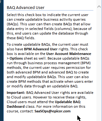

Give us some some screen shots then. What are your permissions on your user account? Do you have BAQ advanced user checked? And BPM advanced user?

It’s the “Form To Use” option. Hold ALT while opening the BAQ editor. Here’s more info:
