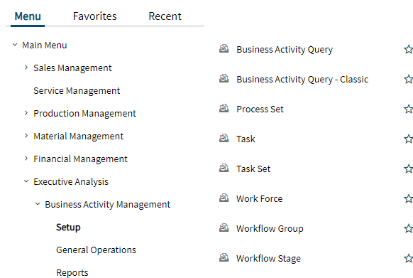

The menu option you’re running probably has the Kinetic Enabled box checked. Click the overflow menu, copy to new menu, and create a new menu item. On the new menu item, uncheck the “Kinetic Enabled” box. I have the menu description of this one called “Business Activity Query - Classic”, so my menu tree has both options available to me:
