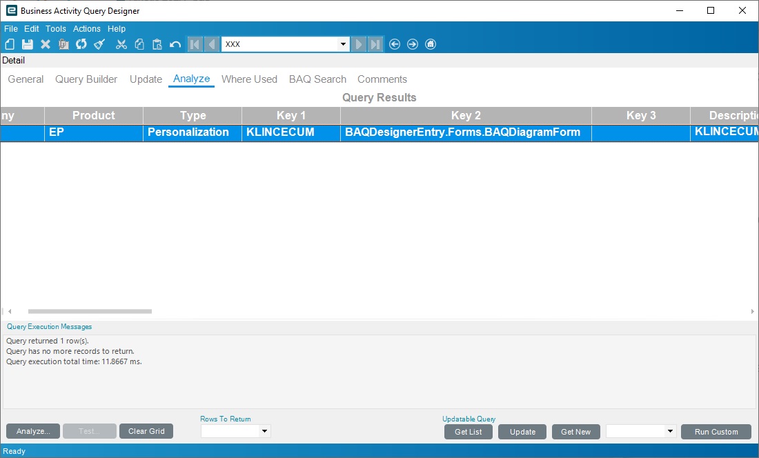

heh heh heh, I got it…
How?
The designer does load personalizations. It just does not let you edit them.

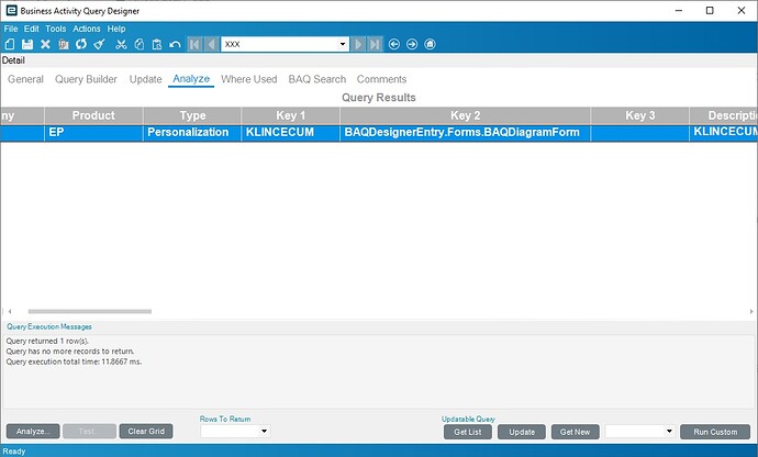

You can create one by saving layouts.
I then made an updateable BAQ on XXXDef and found my personalization.
I took the dll apart to find the FormsID, Control Name, and Guid.
Then I added this into the Content on the Personalization:

Word to the wise. I got it working and it’s such a life saver! But don’t set the font to 16.
It wasn’t working at first. I didn’t copy the key in properties. I figured that out, updated the BAQ. Closed and reopened BAQ and then I had no buttons on the analyze tab. I ended up having to use REST API, grab the BAQ and update the content to 12. All is well now.
