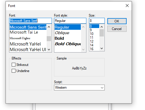

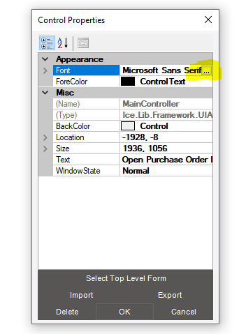

Hello @Lynn , if you select the “Tools” option at the top of your ribbon then select “Personalization” the Control Properties window will open, then you need to left click into the grid of results to specify what your trying to modify (I assume thats what you’re trying to make bigger). then you’ll see an option to make the Font bigger. Note, this is at the user level, not global. Hope this helps.

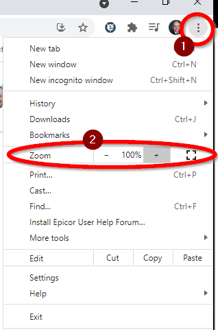

Something to remember… once you move to Kinetic, the size of the text is adjustable with the web browser… My personal opinion is that if you are going towards Kinetic, you spend time on that interface rather than the old interface that is changing.
Hello @Fernando thank you for your reply. However the way you mentioned is only useful in original program and it doesn’t work in Dashboard (made by BAQ).
Hi Lynn,
It is working by following Fernando’s method.
One thing you missed is to select the grid first before changing the font size.
I was seeing nothing changed like you did, and then I realized that I need to select the grid first. Now my dashboard has a bigger font size!
