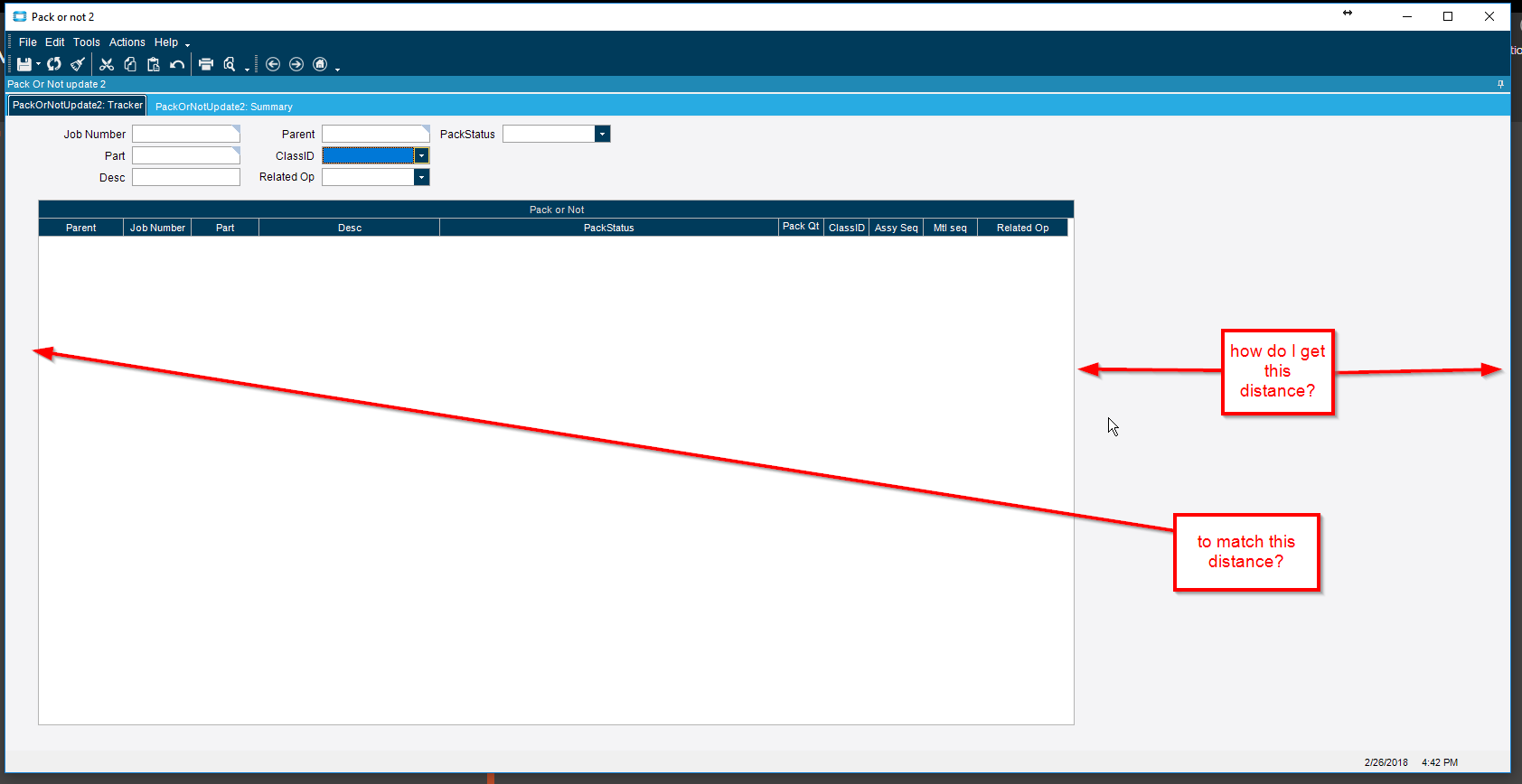

So I figured out how to set column widths, but I cannot for the life of me figure out how to set the anchoring for the bottom and right. When I google it, it usually pops up “Use the property screen” which doesn’t work in epicor. I tried Adding
this.MainGrid.Anchor = (System.Windows.Forms.AnchorStyles.Top …),
for each of the sides, and it seems to anchor them now, however, the distance from the edge is too large. I think it has to do with padding right? Or do I have to get the window size as a variable so I can do the math in the customization to set the grid size correctly? Any hints would be appreciated.
Regarding the formatting, have you tried turning off UseAppStyling?
Regarding anchors, they are relative to the size of the screen when you set them. So if you adjust the grid to match your form (or however you want it) manually, resizing should then affect your grid proper (assuming you’ve anchored all sides)
Ok, so I was able to get the size of the form to stick using the properties, and I inserted
	this.MainGrid.Width = 1150;
To get the grid size to match up. So I think I am good there.

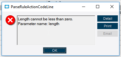

Do you just ignore the error that comes up about the length when you open up the customization editor? I’m assuming it has to do with the rule actions not matching the autogenerated code any more.
Yep just been ignoring those. I get 8 pop up for all different row rules!!
If you can solve that, amazing!!
Good to know.
