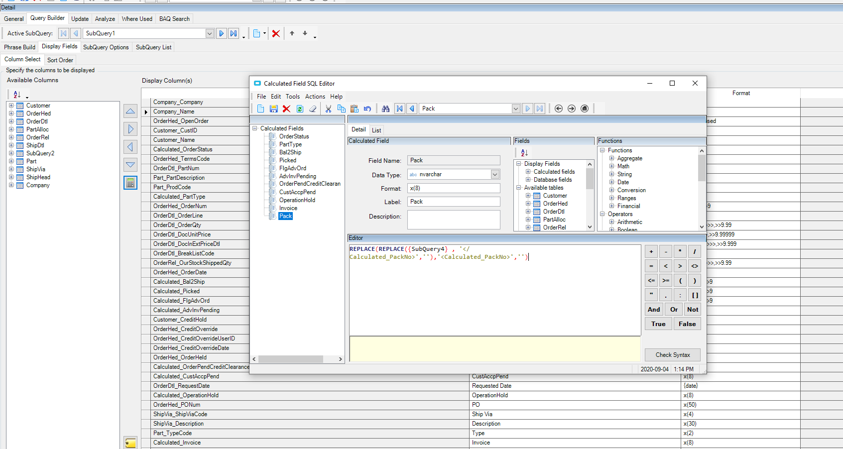

Hi, I am trying to write query for sales order information, this query would provide all information related to sales order, I am finding difficulty with writing query for Pack no, this is what my results are, based on the query I have written its deriving duplicate pack number.
Is there a way to combine sales order and line number in the query

Thanks Jose, I checked that thread, it provides solution to query from single field, i.e deriving PO to Job, but am looking for sales order and line no combination to derive packing slip, I had no issue in deriving invoice number, but am finding it difficult to program for combination.
other option I was trying was to create a UD - Userdefined filed with combination of Sales order and Line no and then using it in the query.

Here’s one I’ve used recently. The subquery:
Note: the “Distinct” will filter out duplicates.
Note: your connections will be different, but you’ll need ‘FOR XMD PATH(’’)’ on the end of the last criterion expression. That’s two single quotes inside the parentheses.
REVERSE(stuff(REVERSE(REPLACE(REPLACE(({SubQuery4}), ‘</Calculated_DetailPlantList>’, ‘’), ‘<Calculated_DetailPlantList>’,’’)), 1, 1, ‘’))
The reverse/stuff/replace removes the trailing comma.
Disclaimer: I’ve stolen all this from other, smarter folks.
See if this helps.
