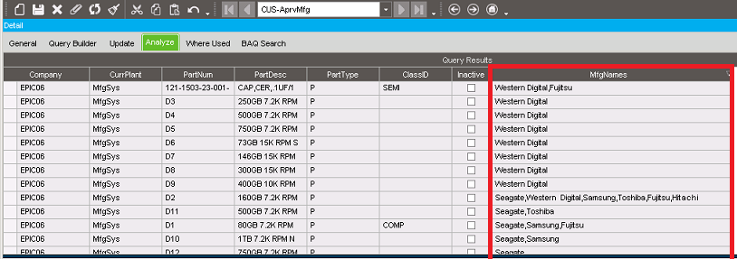

In my case, I want to connect the AprvMfg table and Manufacturer table such that each row of my result set consists of one column containing the part number and a second containing a list of all manufacturers for that parts. I even downloaded and imported the sample BAQ from @josecgomez and tweaked it for my needs. Yet my result still is like this (looking at three different parts for testing):

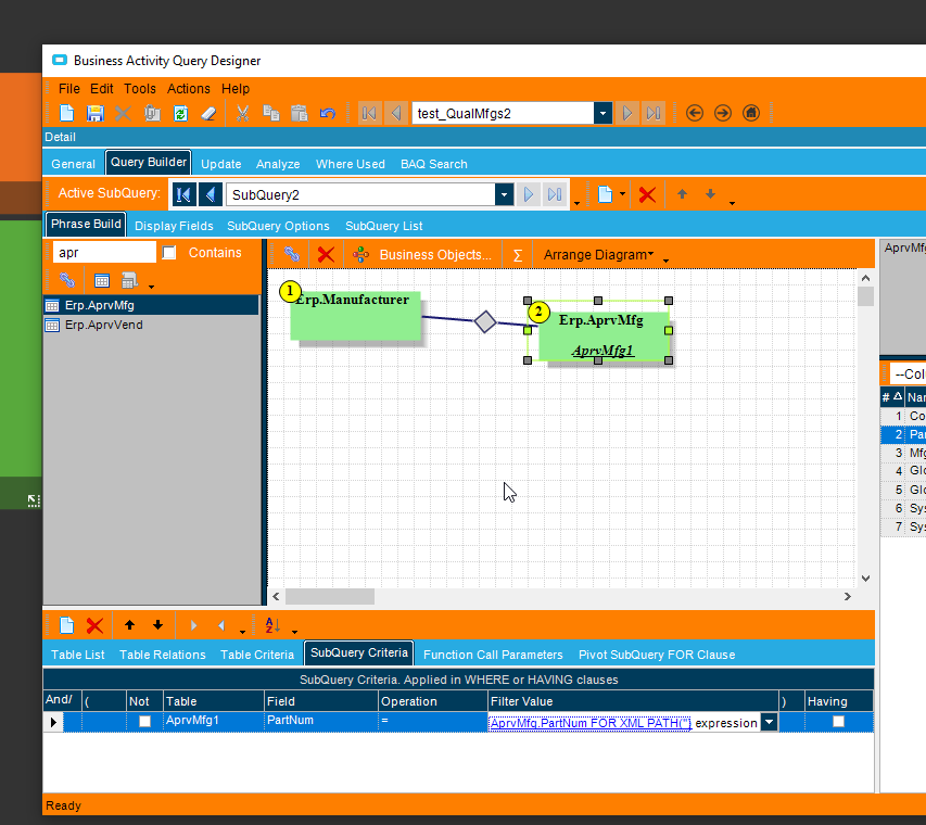

Looks right per Jose’s BAQ which works. Have you tried swapping the tables so Manufacturer is the top table? We don’t use these tables so I have no data to test with.
select
[AprvMfg].[PartNum] as [AprvMfg_PartNum],
(REPLACE(REPLACE(((select distinct
(',' + Manufacturer.Name) as [Calculated_Name]
from Erp.Manufacturer as Manufacturer
where (Manufacturer.MfgNum = AprvMfg.MfgNum FOR XML PATH('')))) , '</Calculated_Name>',''),'<Calculated_Name>','')) as [Calculated_Names]
from Erp.AprvMfg as AprvMfg
