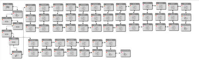

Thanks @klincecum , appreciate the help. There was a lot of changes that needed to be done, so I skipped the code and made @JasonMcD proud with widgets instead. It is working as I needed it too.
Uhhhh…
That scares me.
It reminds me of the Idea to allow us to set many fields in one widget:
Within BPM & Epicor Functions designer, allow the SET widget to set multiple variables/fields
Man, even @aidacra can’t get it expedited, eh? 2.5 years now…
Anyway, that’s not what those are after all - those are all “Update Table by Query”? And you had to do them all individually???
Unfortunately, yes. I’m hijacking a BAQ and that is what needs to change in the dataset tables. Each one is a separate set of filtered fields.

:man_shrugging: Solution I came up with to my problem. Might be a better way, but I don’t know of it. :rofl:
