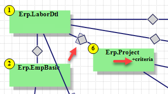

There is an outer join to the Project table to the LaborDtl that has a filter criteria on the Project table.
That will remove any Project records that don’t match the criteria. But it won’t have any effect on the LaborDtl table.

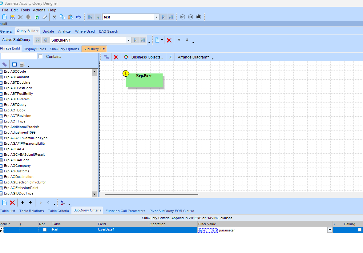

If you want to do something like “Exclude LaborDtl records where the associated project is inactive” you want to use a SubQuery Criteria.
Those will be take effect after the query results are generated and apply to the resulting dataset rather than a specific table.

Try putting the criteria in you subquery criteria (it’s a tab on the bottom) instead of on the table. (edit: what @Waffqle_De_LaCroix said)
Can you post a picture of all of the tables and joins?

You want your selection done after the query runs, sort of a filter of total data.
Putting it on the table filters the table data first. Which is not what you want to do. You want your dataset to return just the items selected.

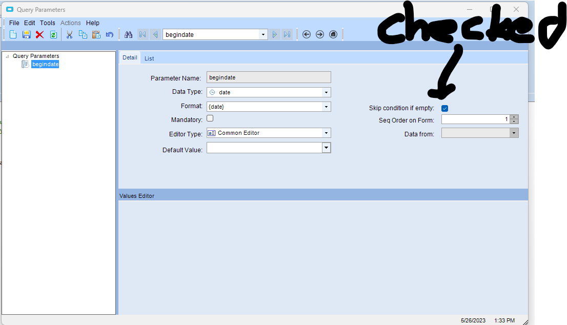

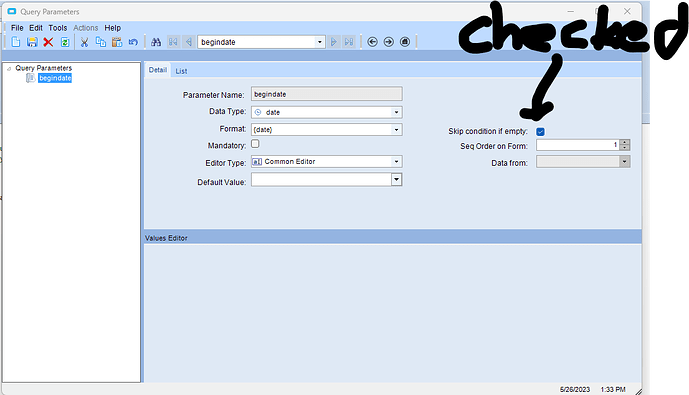

Make the Parameter Optional by checking the skip condition if empty

SubQuery Criteria
