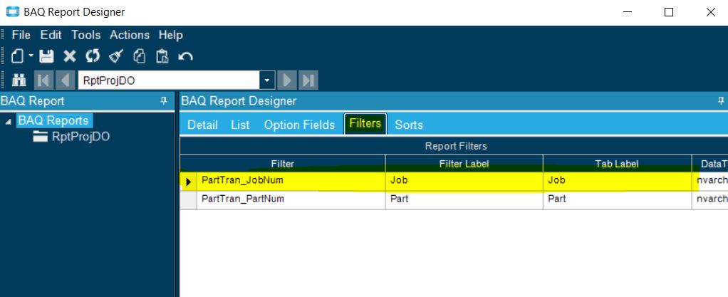

Dear Experts, We have created one SSRS report using BAQ Report Designer and added one filter (Job Number) refer to below screen

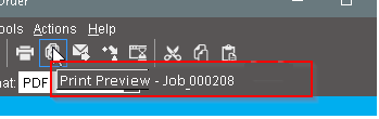

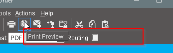

What are you trying to achieve? You want the Job Num that was selected on the Filter Page to be added to the tool tip when you hover the Print Preview button, so that:
would become:
Not sure what you’d want if multiple jobs were selected. If it is only ever going to be one Job, just make that an Option, not a Filter.

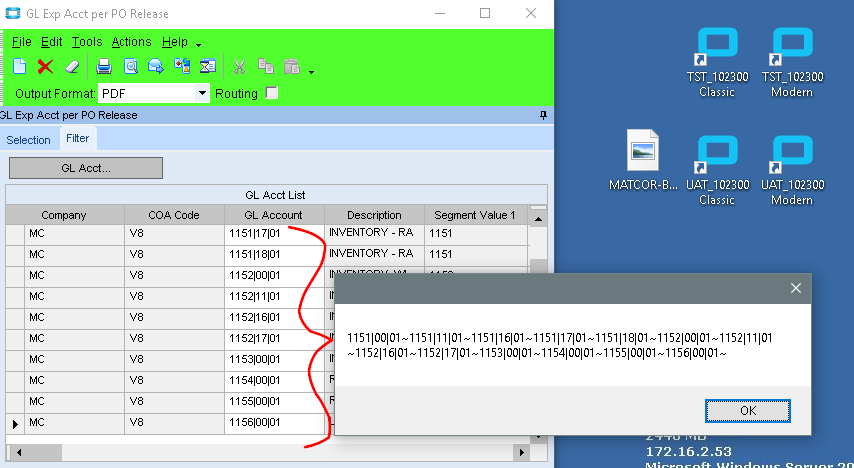

What about referencing the grid object that has the selected filter items displayed?
@Hari_Dutt
The following code will build a string of the values in the ‘GL Account’ column of the Baq Report filter
private void baseToolbarsManager_ToolClick(object sender, Infragistics.Win.UltraWinToolbars.ToolClickEventArgs args)
	//EpiMessageBox.Show(args.Tool.Key);
	switch(args.Tool.Key){
		case "PrintPreviewTool":
			// GUID 1ebf2c58-8e74-493a-a494-2637d6912176-1
			// EpiUltraGrid
			string myString = "";
			EpiUltraGrid eug =  (EpiUltraGrid)csm.GetNativeControlReference("1ebf2c58-8e74-493a-a494-2637d6912176-1");
			Infragistics.Win.UltraWinGrid.UltraGridRow[] filteredRows = eug.Rows.GetFilteredInNonGroupByRows();
			for(int i=0; i < filteredRows.Length;i++){
				myString = myString + eug.Rows[filteredRows[i].Index].Cells["GLaccount"].Value + "~";
			EpiMessageBox.Show(myString);
			break;
