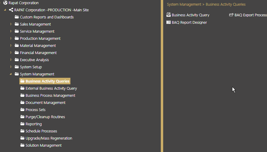

Below is a pictorial step by step. I didn’t put in every single click, but it should get you close enough to see what’s going on.
Here is the menu location. It exists in a couple of other places too.
Once you open it, create a new query
