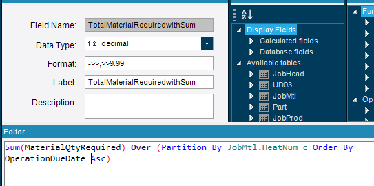

Sure, as you can see in the image below while it does calculate a correct total for all 3 it is not doing it for each individual row but giving one total for all 3 rows which unfortunately will not allow me to determine at which operation we would be out of material
What’s your due date? If you date is the same, then it won’t know which is first, so it lumps them together. You need to add another sort in there to make sure each line is unique. Try this (whatever the opSeq field is)
Sum(MaterialQtyRequired) over (partition by JobMtl.HeatNum_C order By OperationDueDate, opSeq)
Thank you. Operation due date was the same so I was able to find a field to use.
