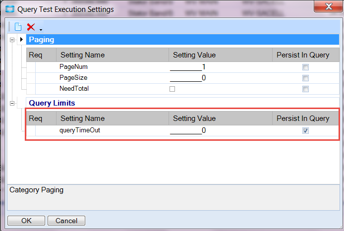

I have the BAQ execution setting as:
Sorry to necro an old post, but I was having this issue in 10.2 and googling brought me here, so I figured I’d post what I found for future seekers.
My query was timing out at 30 seconds. Both when executing it in the BAQ Designer as well as through the oData link calling my BAQ. My queryTimeOut setting was also set to 0 by default. I set the value to 60 and saved the BAQ, and then my BAQ started working–showing it was taking 38 seconds to execute.
I’m guessing the queryTimeOut was inheriting 30 seconds from another setting somewhere, regardless of being set to 0 (which I would interpret as unlimited) and only by changing this value to an explicit number caused it to override that inherited value.
