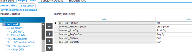

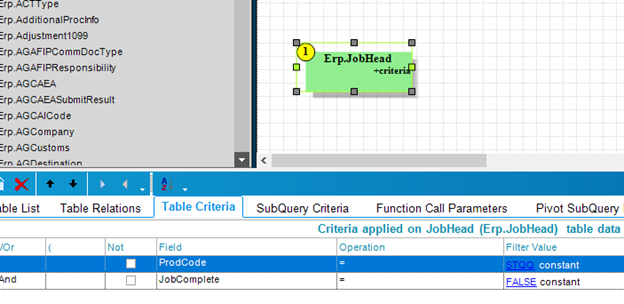

I’m trying to turn a simple BAQ into a SSRS report to email. BAQ is simple, all fields from the JobHead table.

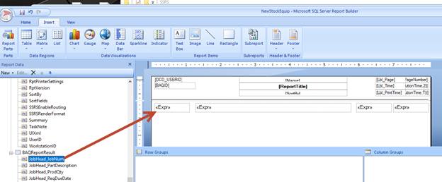

Created report in BAQ Report Designer, then off so SSRS. Get to the report designer and put in the BAQ Report Results and it pulls the first row. How do I get to to pull all the rows in the BAQ? Note: I do not like SSRS <> So close, any and all help appreciated. Thanks!

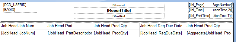

You have to insert a Table in the SSRS report, which guides you through a Tablix Wizard.

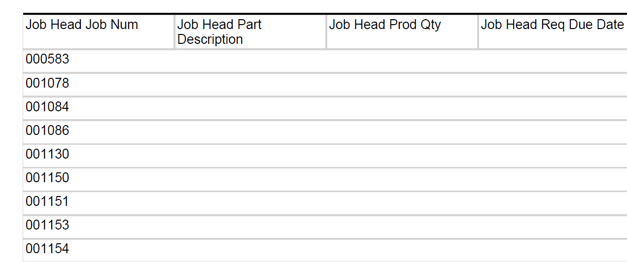

Went through the Wizard and added the BAQ fields. Pulls all the correct job #s but not the other fields.

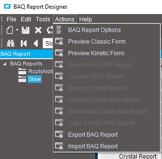

Hope you can help – I have created a BAQ and that works perfectly well for what I need. The issue is that when I try to create an SSRS in the BAQ Report Designer it gives me the *.rdl file name – But I can seem to find it on my Report Server?
Also I am not “Download SSRS Report”
