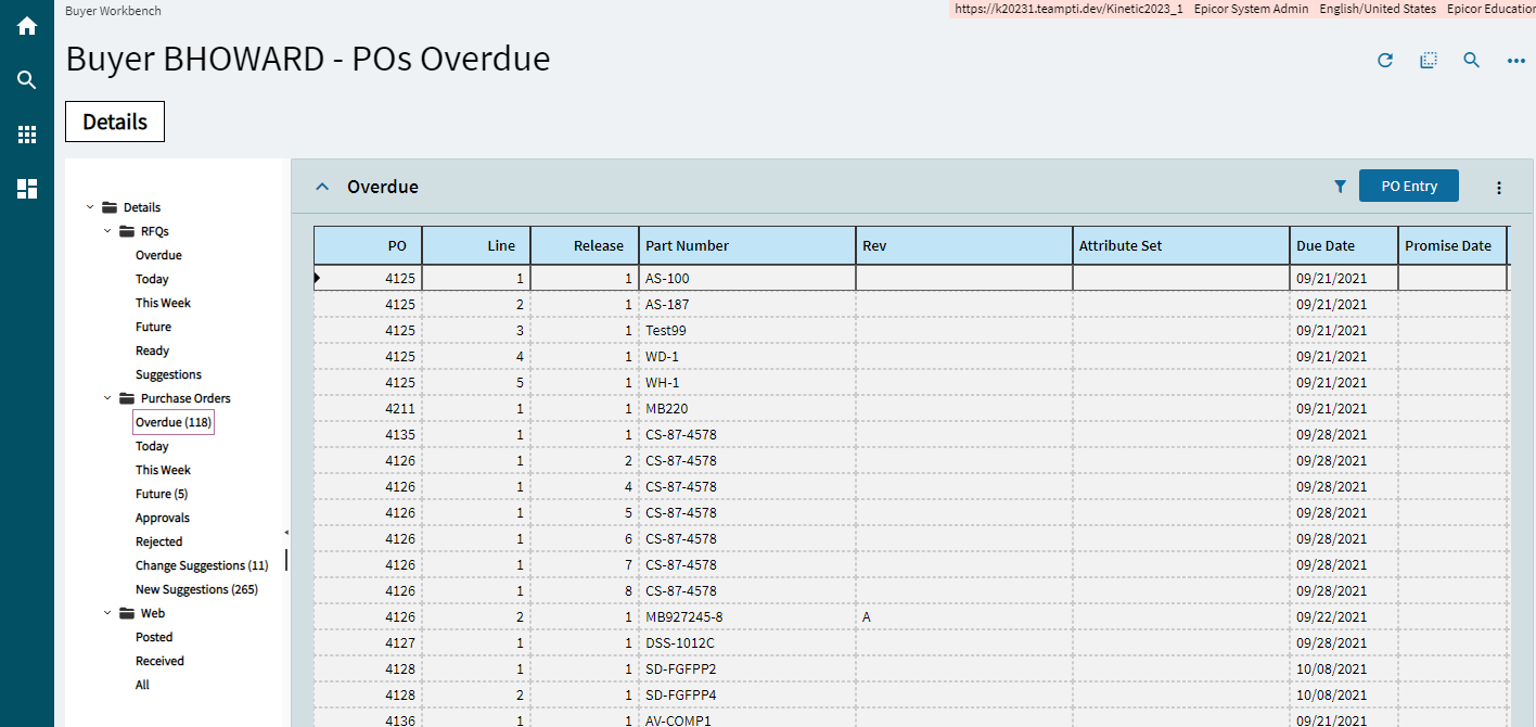

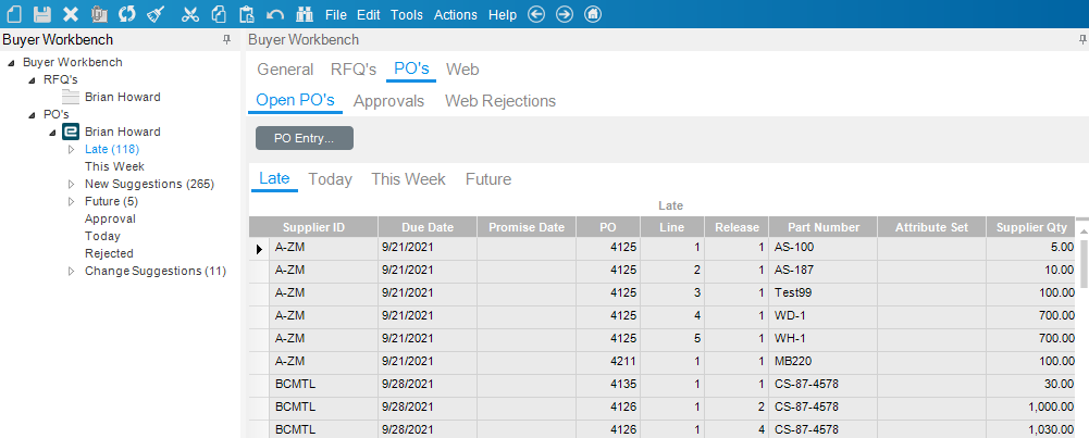

Are your buyers familiar with the Buyer Workbench?
or if you’re running Kinetic UI
User Account Security Maintenance > Load up your user, then look at Options. Make sure SSRS Report Designer is checked. While you are at it make sure you are a BAQ Advanced user, and BPM advanced user. You don’t need those for this case, but it could be helpful in the future.
Yes, they are familiar with buyer’s workbench. It is the ultimate goal to get them to utilize that correctly, but as of right now it’s a bit messy. We have a very small team of two buyers right now, and they prefer to be notified when something is past due. I’m not trying to promote poor practices, but we need to get a few things cleaned up before they can start utilizing this program properly.

Sure, we had the same thing with our buyers. And then they started to complain that we were sending a report of late items but between print time and when they got around to following up with the suppliers, some of those items were received. They would call the suppliers and ended up looking bad asking about delivered items. They’ll get there eventually. Maybe you can add to your report the tab on the workbench that shows what is due this week, so they are notified to follow up before they are late.
Makes sense. We’ve ran into similar issues with the current utilization of buyer’s workbench where the item is showing past due, but in reality it just hadn’t been received in the warehouse yet. So the buyers go to the vendor, the vendor says it’s delivered, and we look bad.
Yes, that is a bigger issue if receiving is done late since it shows up on both the report and the WB.
