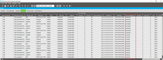

I too am trying to figure out what the numbers in LoadDays represents. Has anyone figured it out. I checked all the refence guides and forum posts related to this and no one seems to know. It looks like the number of days since 1/1/1999. Can anyone confirm this?
I would really like to see each of the days that are scheduled in the ResourceTimeUsed table as individual days. Right now if an operation takes 4 days on one resource, I only get one row in the table with a start and end date, along with the LoadDays field. I would like to convert load days to actual days, so that when I query the ResourceTimeUsed table I can see each of the days that a resource is scheduled. I think I could do this with some fancy subquerying. Is there something built-in that does this already?
Thanks!
RTU_Daily.baq (53.1 KB)
Yes, Load Days is number of days since 1/1/1999. The attached BAQ contains an example of the ResourceTimeUsed table flattened out to daily load. I’ve used this for a bunch of different scheduling dashboards.

It looks like the days aren’t showing correctly. I thought they were at first, but I can see now that the load days aren’t lining up with the operation finish dates for ops that span multiple days. I am trying to figure it out. This looks like exactly what I wanted if I could just get the days to show correctly.
EDIT: I think I see the problem. The BAQ you sent only shows days with load from the ResourceTimeUsed table. This is great, and it does show the right days, contrary to what I wrote above. What it doesn’t show are days where the job is out of the shop (subcontractor ops), or in an op with infinite capacity. It seems both of these cases leaves the RTU table empty since shop resources aren’t being used.

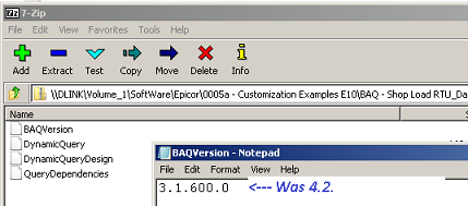

There is a trick that sometimes allows importing BAQs from “latter” versions
Someone else posted these steps before me but… I can’t find that original link.
Here is the general idea:
a.) Copy & rename your BAQ export with the extension “.zip”
b.) Open the “archive” with 7-Zip
c.) Find the the file BAQVersion in the archive, open with notepad, edit the version numbers to match your target system and save to the zip archive
d.) Remove .zip extension from the file name of the copy.
e.) Try importing that BAQ, it usually will work now
Nifty!
Yeah, I wish I could give credit to the original person but I can’t find that link again.
Being able to import to earlier versions has saved me countless hours.
e.g… I was able to successfully import your BAQ to an old 3.1.6 system
Sometimes you might need to make some adjustments after importing but many BAQs will “just work” in earlier versions.
