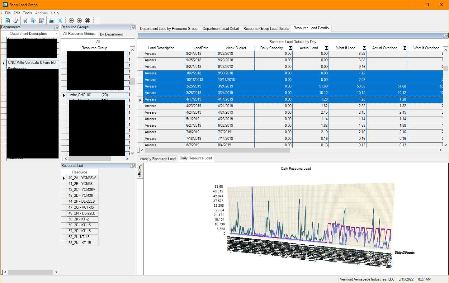

I am running the Shop Load Graph dashboard. I found under: Production Management > Scheduling > General.
I selected a resource group I am interested in. Then I review the Resource Load Details tab. It shows a spreadsheet of load, dates, and hours. There are a lot of older dates in there, with a Load Description of “Arrears”. There are a lot of entries in there with 0 capacity and 0 Actual Load hours. There are also arrears entries in the spreadsheet for positive load hours in the past.
Recently I have turned off scheduling in the past, and I rescheduled my jobs with global scheduling. I thought this would get rid of my load that is in the past, and show it as load from today forward. After all, we can’t build parts in the past.
So how do I get these entries on the Shop Load Graph to go away? There is no job number reference in this report.

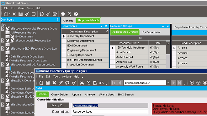

Looks like that is a calculated field from BAQ zResourceLoadSLG.
when SubQuery1.ShopCap_LoadDate < Constants.Today then ‘Arrears’
else ‘Future Load’
If you haven’t already noticed, this dashboard (ShopLoadGraphSD) can be opened to show all the components. I also like to make copies of the dashboard AND the BAQs which then allows for customizing.

So using the screenshot from my first post, How do I backtrack to find the job associated with the load on resource group 2B on 4/17/2019?
Backtracking from a resource group/date to a specific job/date is tricky - since dates can be capacity based more than job based.
