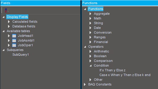

Utilize the tools that Epicor provides. As you can see in my screenshot, there is a case statement that Epicor will insert into the Editor for you. You can then edit as needed if you need more or less WHEN statements.
Putting the Case statement in isn’t the issue. The problem is getting the Select statement into the Else portion of the Case. If I try to put in anything starting with the work Select it seems to throw the SQL Injection error.

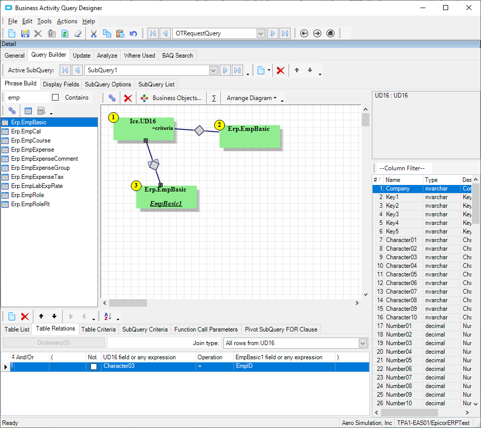

Add the EmpBasic a second time and do a left outer join.
The left outer join is only returning the rows that have the UD16.Character 03 filled in. Unless I am linking it wrong. Here is what the sql looks like:

Can you post a screenshot of the BAQ? Specifically the Phrase Build.
