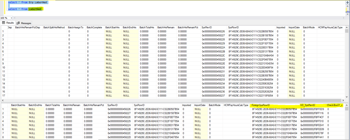

You will probably have to do a join between LaborHed and LaborHed_UD. In BAQ Epimagic takes care of it.
In SQL change the from table of any unknown columns to dbo from erp and that will give you the view which is the join of the system table and the _UD table.

try this

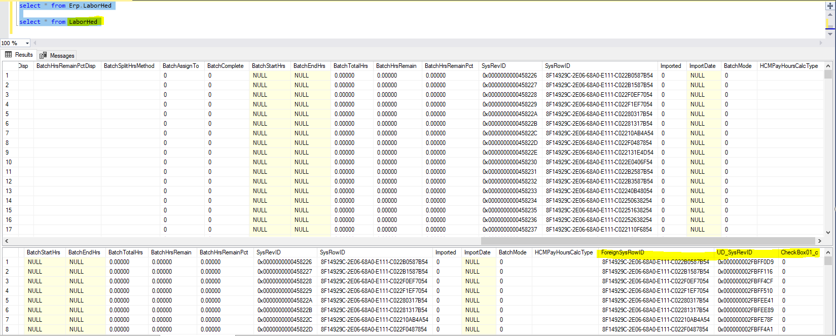

once first UD field created on any Epicor table, the view table that you should use is without Erp. nor odb. just the name of the table
