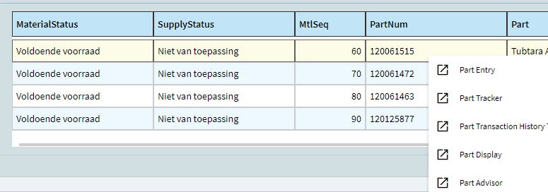

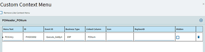

I found that when using a BAQDataview in Kinetic that the right click Context Menu’s arent’ showing up. The Like properities look correct on the BAQ itself.

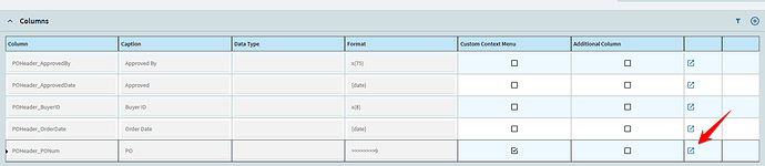

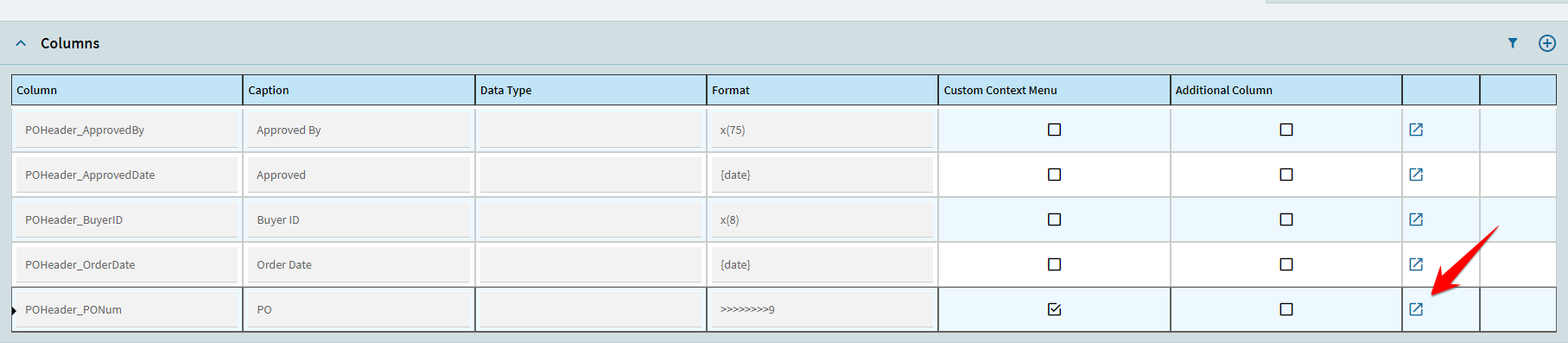

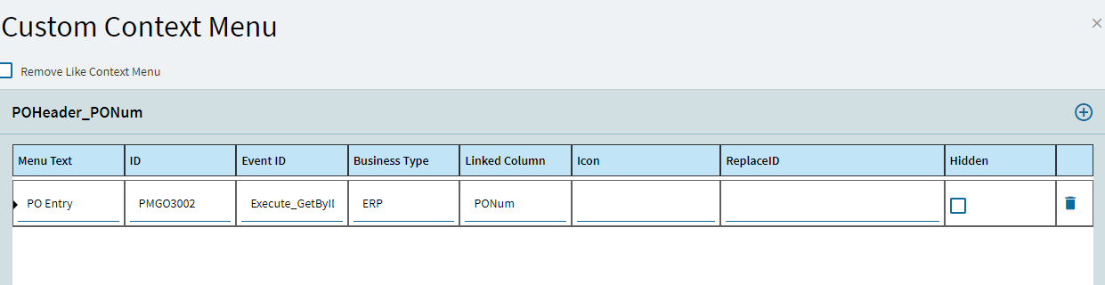

I’m guessing this is how you can set them up manually, but my current setup doesn’t seem to work. Has anyone gotten this to work propertly
*Try to open up the PO Entry screen from the PO.
Which version are you on? I have several BAQDataview all with the context menu info.
no custom context menu needed
Ended up being quirky but not totally broken. The context menus aren’t there until collapse and re-expand the panel card for my grid view. I can live with that for now.

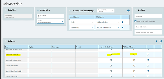

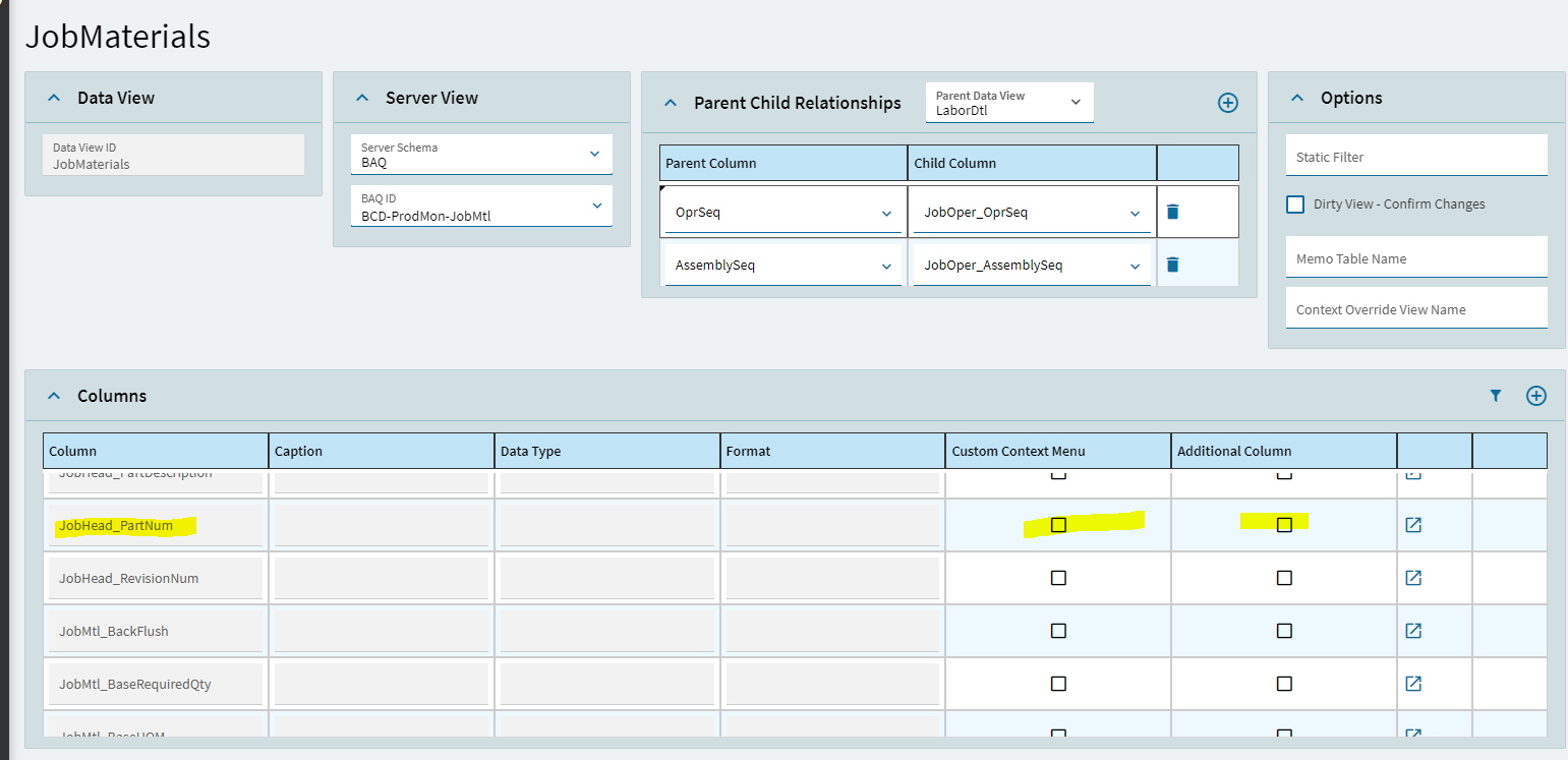

This doesn’t seem to work with BAQ calculated columns. Normally I specify a calculated column’s LIKE in the BAQ editor’s “Field Attributes Editor”. This works for the classic interface.
