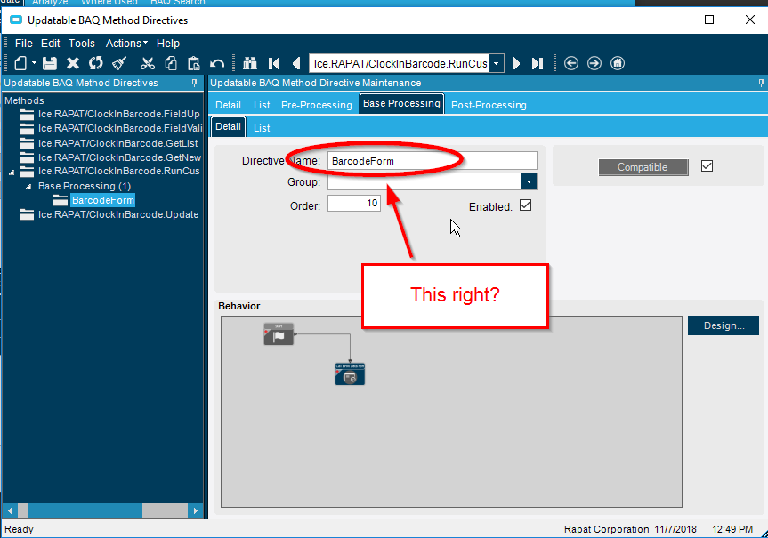

So I’m getting the custom action set up, is the link for the custom action the name of the base processing BPM for RunCustomAction? I got it working, but it seems like one of those “magic string” type linkages and I get warned about all of the time. I just want to make sure I understand the mechanism that I am using.
no, there is a parameter in that method which contains the actionID. You just need toput a condition node that checksif ActionID = “” Then CallBPMForm
So like this. If I don’t put that in there, it would run every custom action that has a base process, right? Thanks for the clarification, that’s why I asked.
Correct

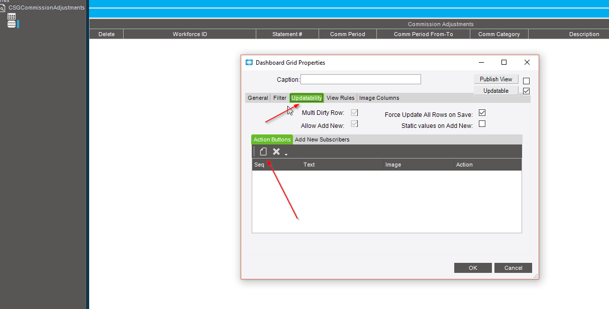

One more question (for now anyways), do custom actions always have to be called through code then? I was sort of expecting these to show up in the actions menu of a deployed dashboard, but it doesn’t. Is that expected behavior?
They will show up in the actions menu. If you add the action in your Dashboard.

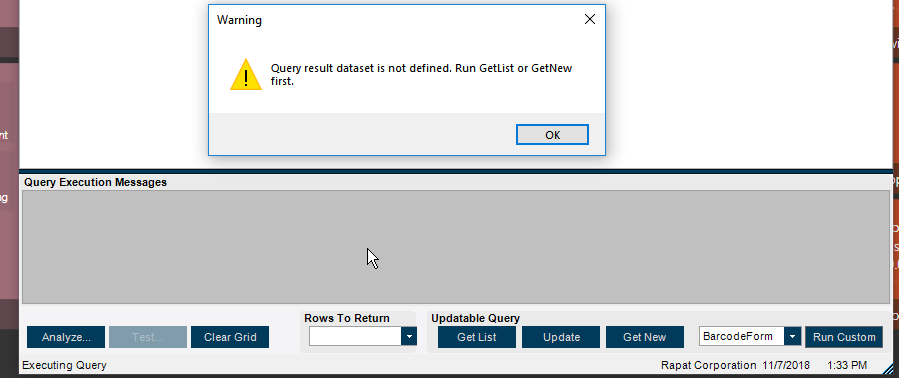

Interesting conundrum. If I don’t have any information in my grid, the BPM form won’t fire. I don’t want to populate the grid until the BPM form fires so that I can get the filters in place. ugghhhhh…
Any slick ideas on how to do this? Should I just look at customizing the parameters form? Can I do that? I’ve seen where I can get in and customize it, but I don’t know how to apply it. I would imagine that I have to set the customization in the Processes section of the Menu Maintenance?
