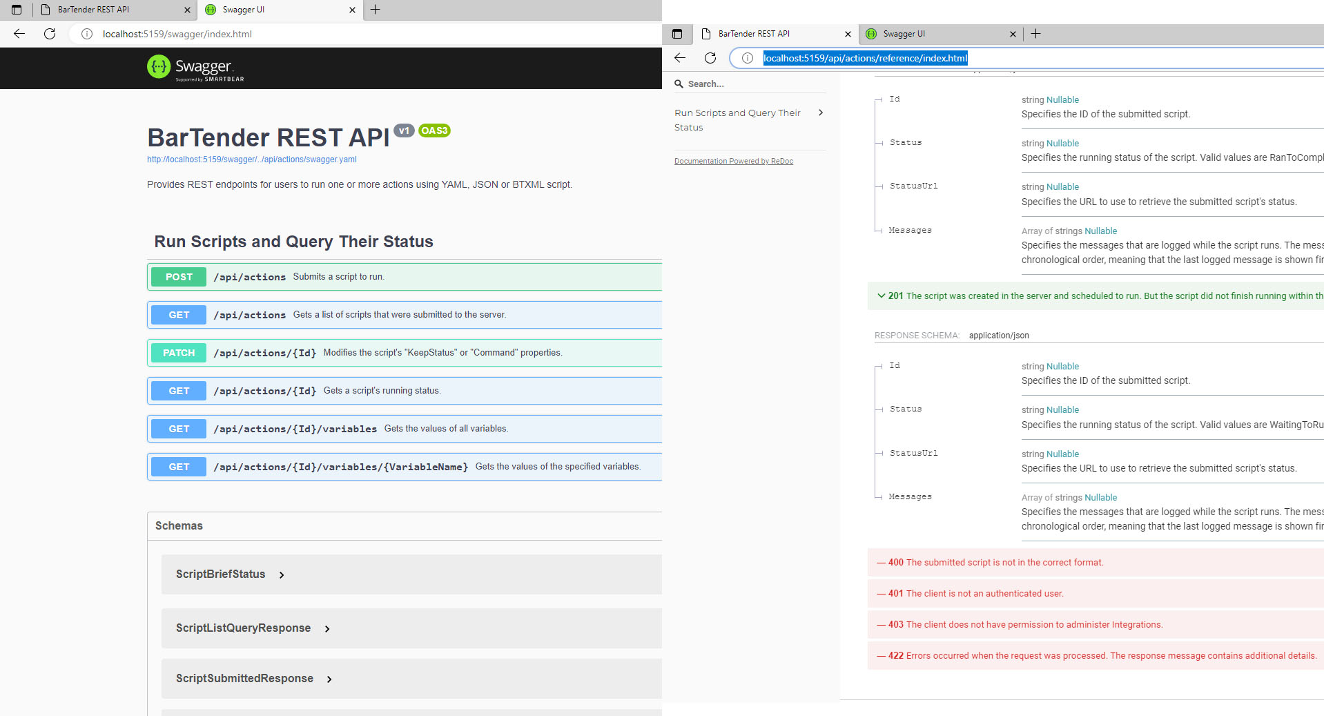

Bartender 2022 has a bit more information.
I am glad…
The hard part is the 201. Where it’s successfully there but doesn’t finish or something like that. Like the integration runs but user is just sitting there wondering what happened.
