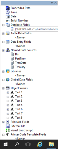

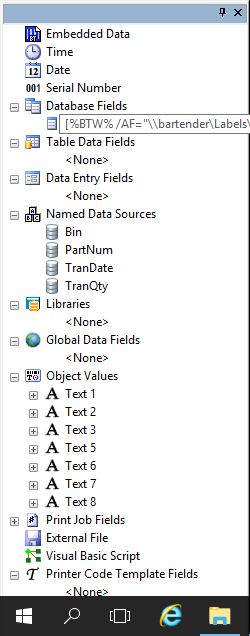

I noticed the btw file updates to the following Database Fields and not use the GenInv file.

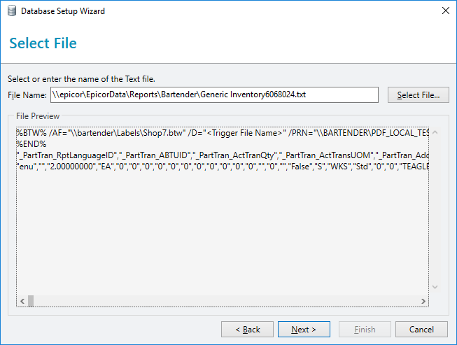

It’s because above the table data is this information
%BTW% /AF="\\bartender\Labels\Shop7.btw" /D="<Trigger File Name>" /PRN="\\BARTENDER\PDF_LOCAL_TESTING" /DBTEXTHEADER=3 /R=3 /P
%END%

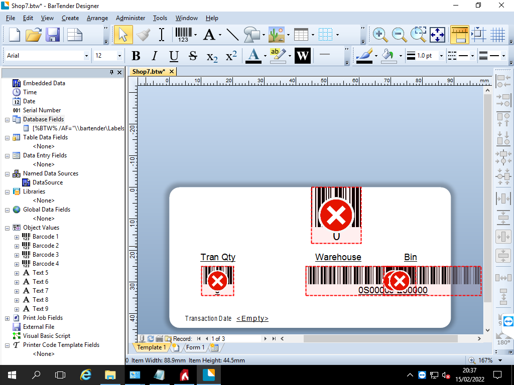

I’m getting this
The following database fields are referenced by template objects but are not present in the database. Proceed with empty values for these fields?
	_PartTran_TranQty
	_PartTran_PartNum
	_PartTran_WareHouseCode
	_PartTran_BinNum
Delete the first two lines and save it as txt. Close the file and then use it in the Bartender Designer.
First two lines are only needed by Integration and should be removed when used to design the label.

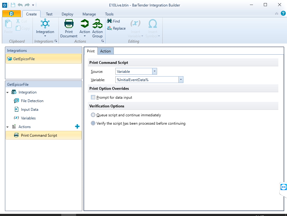

I did this but when I run the bt file through integration I get this
	_PartTran_TranQty
	_PartTran_PartNum
	_PartTran_BinNum
I had the wrong variable set. It should of been %EventData%
