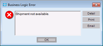

But that requires that you select the packers to reprint. If you don’t select any You get:
So I need away to pull the data for all packers - and then filter out packers with ChangeDate not equal to Today (in the report rendering / RDL)

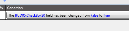

  • Create a Condition with:

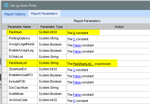

  • Add an Auto Print widget:
    • Select PackSlip Report and config as:
Now to make this fire, I use a Windows task to run a power shell script that runs DMT to update a specific record of UD05.Checkbox20, to true then to false. Details on the PowerShell script calling DMT can be found in another post I made here.
