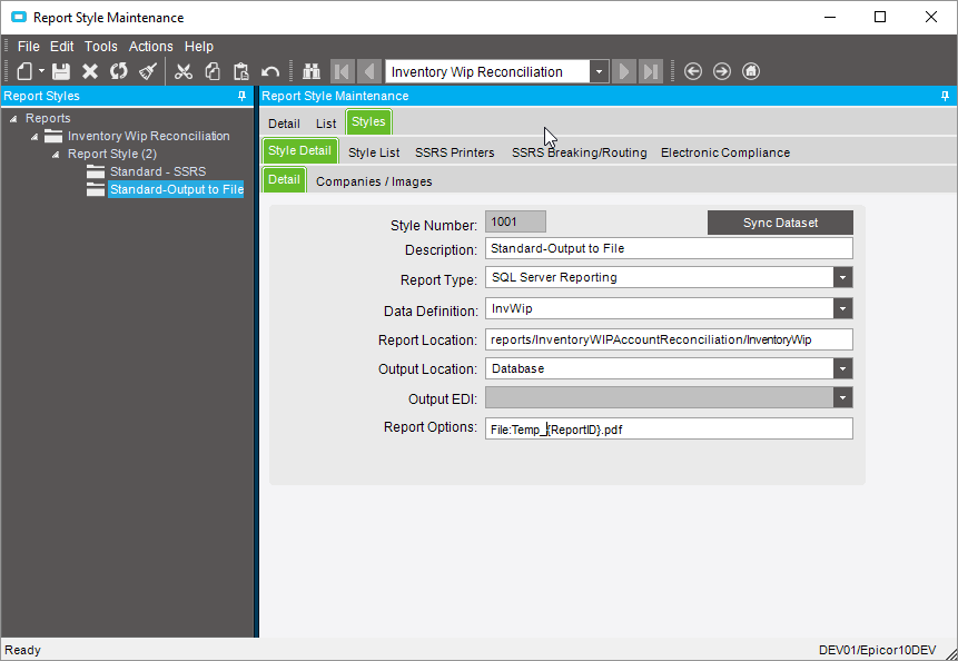

Solution could be a data directive on OrderRel, check the value to that field, if true, then print. In the Report Style that you’re printing, the argument “File:” plus whatever you want to name the document will put a copy of it out on the server.
This puts it to image

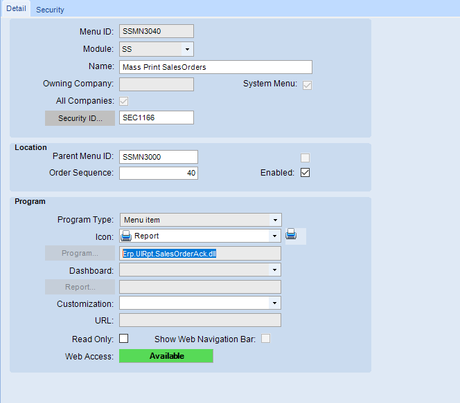

Is this a built-in form / report?
I’m not aware of batch print Sales Order Ack.
It’s not included in the menu for some reason or another, but it’s a ui library you can add in, been there since 9 just hiding.
Hot damn… looks like it’s added in 10.2.400 by default. I’ll have to check this out.

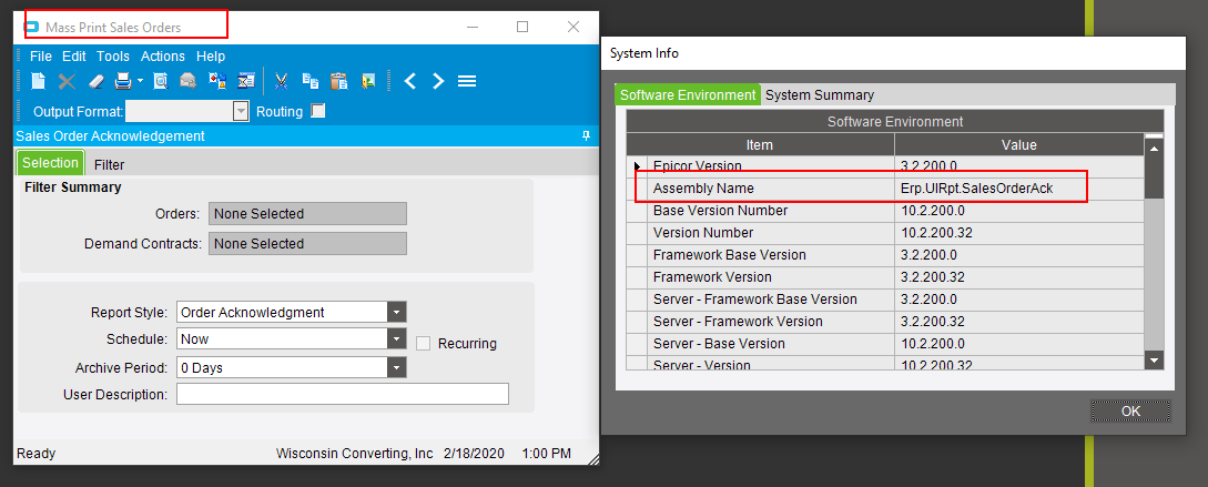

I do want to explore the ideas that @Aaron_Moreng and @ckrusen had. Either would be ideal as it would require no intervention from users. But until we get there a mass print would help a lot.
So its the same program/form as the one that launches from within Order Entry (or Order Tracker). But with a button to select the Orders.

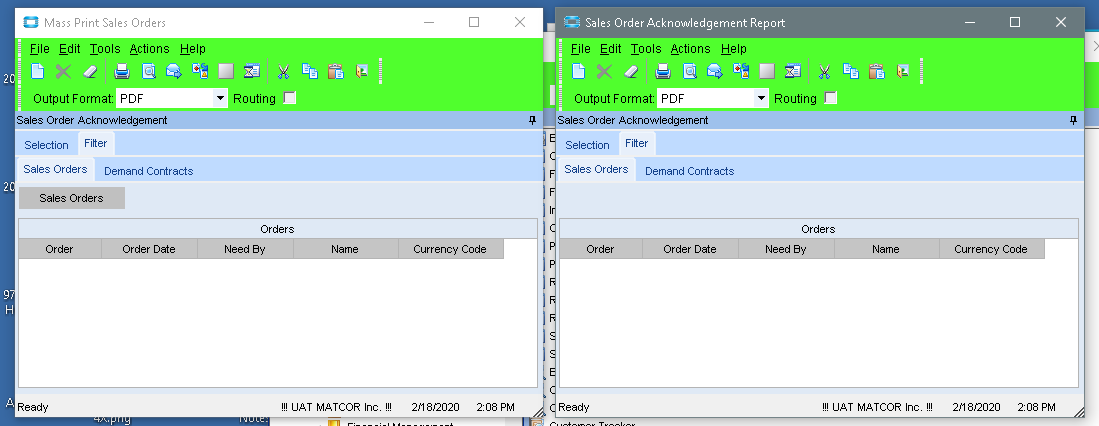

“Mass Print” on the left, and Print Order (from within Order Entry) on the right
Edit
one more thing… The Sales Order Ack (launched from within Order Entry), is modal. No other E10 client window will respond while that window is open.
They should just use the mass print window in Order Entry… :upside_down_face:
As I pointed out earlier, it prints as a “single report”. So if you selected 10 orders, you get one PDF with all 10 orders in it. Would need to use Break Routing (which the OP said they can’t) to break that into separate PDFs or emails.
I noticed that. I ran quick test and got a 100 page PDF. That won’t work to send to a customer. I would have to add something in our document management system to break them. Which it could do but not ideal.
