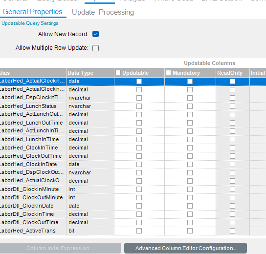

I’ve tried setting this up in our test environment and it’s not working correctly. Do you know if on the BAQ I need to make the fields updatable for this to work? And would I need to select Allow Multiple Row Update? Or should the BPM work regardless of the BAQs actual settings?
Need to mark the fields updatable correct.
