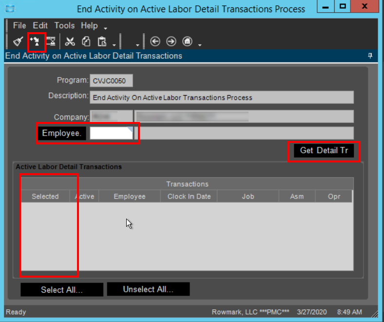

There is a built in conversion program to correct this under System Mgmt > Upgrade/Mass Regeneration > End Active Labor Transactions.
You enter the Employee ID and click on Get Details, select the Labor Transactions that need to be Ended and then the ‘Submit’ icon in the toolbar:

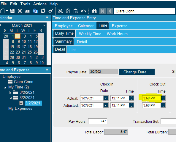

After doing this you can make adjustments to the Labor Transaction via Time & Expense Entry.

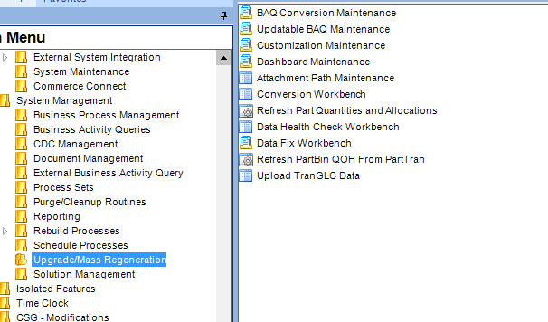

Rich, Did you manually add that screen to the path? I can’t seen to find it on my version of Epicor 10.2500.
It is under Conversion Workbench, then User Run Conversions
Yes, it’s available in the User Run Conversions too.
I don’t recall, but I may have added it to the menu.

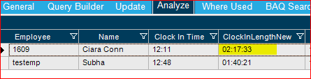

  1. First time I ran the BAQ and expected the employee number 1609 to be clocked out because the clocked in hrs > 2hrs. But it did not clock out.
  2. Second time I ran the BAQ and expected both the employees should be clocked out because the clocked in hrs > 2hrs for 1609 and testemp. But it did not clock out.
Am I using the “double time InLimitHrs” correctly?
Subha
What’s your code look like now. It sounds like it worked the first time at 5 hours and clocked them out as it should have. Now at 2 hours it’s not?
No Joshua. May be my first example is wrong. The code remains the same as I posted above. I am just adjusting the “double timeinlimithours” for testing purpose. Hence I tested with 2hours. I ran the BAQ when the clocked in time hours >2hrs but it did not clockout.
Again I ran the BAQ when the clocked in time is 3.5hrs, it clocked out.

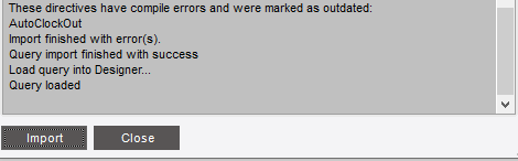

@jgiese.wci I downloaded your BAQ but it didn’t work for me when I uploaded it due to version issues. Would you be able to share a newer version or at least a screenshot of the tables involved so I could replicate it on my end? Thank you, much appreciated!
