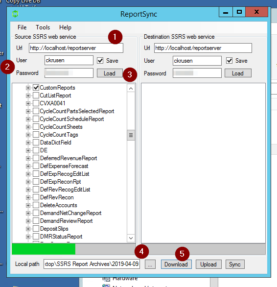

I use ReportSync and regularly make a “backup” by downloading the CustomReports “folder”
  1. Enter path to SSRS
  2. Enter credentials
  3. Click “Load”. Open the Reports folder and check the CustomReports folder.
  4. Choose a destination
  5. Download
And all the “files” in the CustomReports and the sub “folders” are downloaded.
