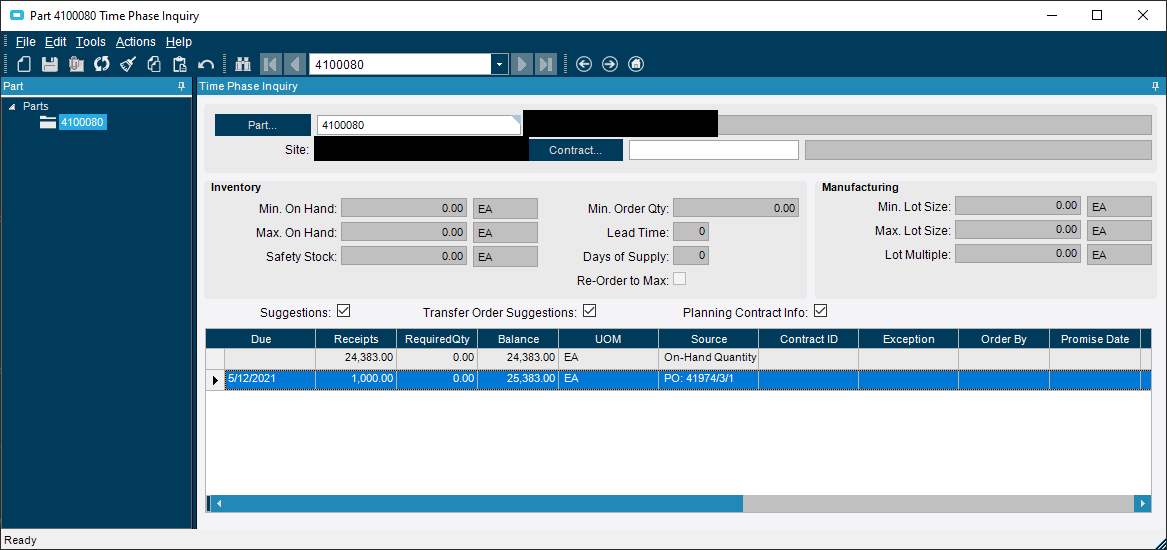

It seems the record is visible in Time Phased Inquiry, but one is not able to delete via this program. It does not appear there is a DMT or a conversion that fits the need of deleting a PartDtl record tied to a PO line.
The reason for wanting to delete the PartDtl record is there is a PO Line that has incorrect data that we are trying to delete (there are no receipts tied to the PO), but cannot with this record in the DB.

To the best of my ability I do not believe there is any labor associated with this PartDtl record, instead it was created from a PO release. This is why the system does not allow the deletion of the PO line, even though there are no receipt or PartTran records.

The only place I know to interact with this record in the UI is in Time Phase Inquiry:

It does not appear there is a receipt in PO Tracker or any records in the RvcHead or RcvDtl for this PO. Note, I did press retrieve :slight_smile:
I presume it’s an expected receipt. If you have a PO/Line/Rel, you expect to receive it on the due date.
