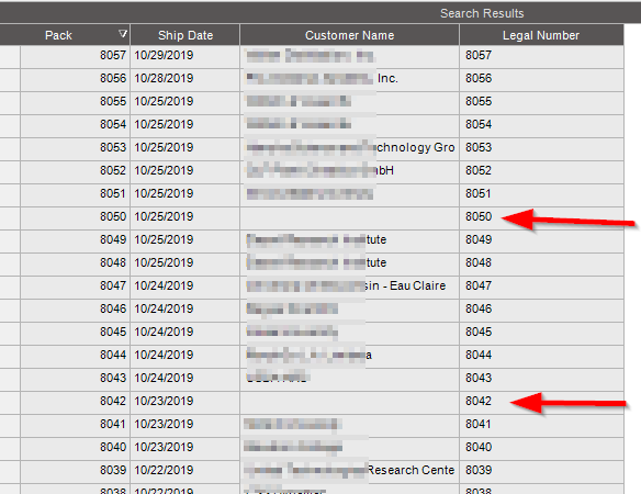

Over the past few months, blank ShipHead rows being generated occasionally. We always ship products by going in to Customer Shipment Entry, new Pack, enter SO number, and proceed with the rest of the shipment, then Print and/or mark the Shipped checkbox. Somehow extra PackIDs are getting created in between those real PackIDs. Here’s a search of recent Packs: The ones with no customer have no information at all except PackNum, LegalNum, and ShipDate. The Shipper says that she does not start a pack, then abandon it.

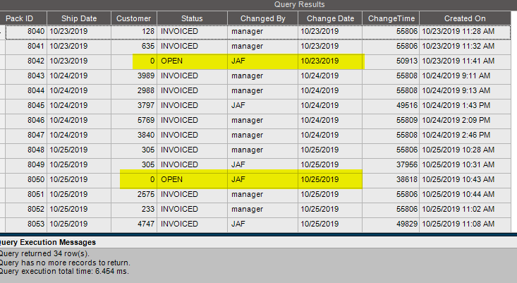

Calvin, I just turned on BPM Change Logging on ShipHead today, so no data yet. And here’s a BAQ with Changed by and Created On (the ‘manager’ entries are when a DMT updates the tracking number after UPS end-of-day processing.
So, the BAQ points to our shipper (JAF) doing something to create the Packs. Maybe as Nancy suggested, creating but not completing.
#8050 has a ChangeTime of 38618, wich is equal to 10:43:38. Which is close to the Created On value.
#8051 has a Created On value of 10:44 (within a minute of #8050.
My guess is that JAF created 8050, then created 8051 and populated that Packer, leaving 8050 “orphaned”
