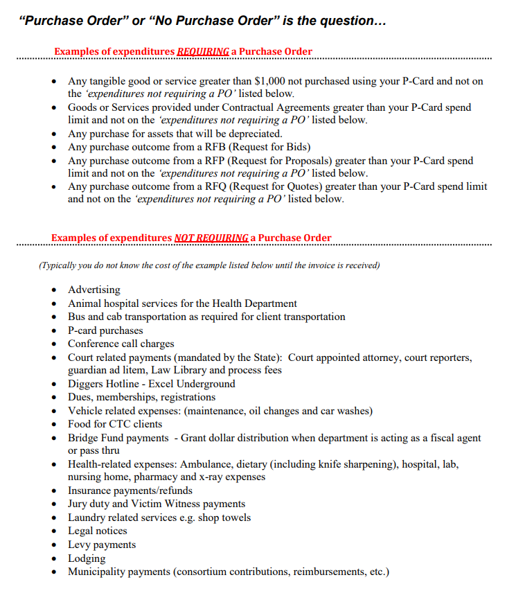

My experience with Manufacturers is that most do not create POs for regularly billed items such as utility bills, insurance, mortgages, etc. I think the reason is that they are processed under more of a long term contract that is not re-negotiated every year (quarter, month, or other period).
One problem with a PO is that once you have a PO, you must also “receive” the goods purchased, and then invoice the amount received. But in the case of utilities, there is no official “receipt”…
I did a quick search on the internet, and found ONE (yes, only one) document from a city in Wisconsin (name withheld to protect the innocent/guilty) that described what should and should not be on a PO… From what I see, this aligns very well with the experiences I have seen in manufacturing (except for the “< $1000” and the “Tobacco products” limitation).
But as with any advice here… you should follow the advice from your management/CPA/Lawyers if it is different than received here.
