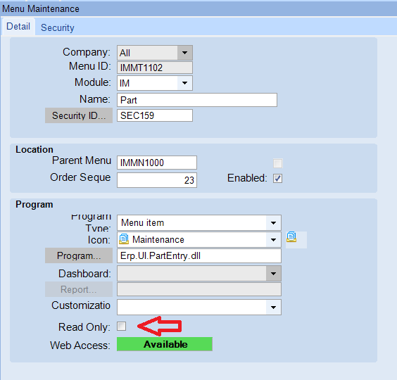

Hi Shawn,
Here’s an alternative that might work for you. Create a new Menu Item for the Part Maintenance program but check the “Read Only” flag.
Because it’s a menu item, you can assign a security ID with the security groups for those who need only Read access.
Mark W.
That won’t work because they want to be able to edit a part, just not add any new parts.
I thought about creating a 2nd menu item and assigning the group to it but wasn’t sure what would happen if they were in another part of Epicor and did the Right-Click -> Part Entry. Would it open the menu they had access to or would it just not work?
I will give it a shot today and see what the answer to that is.
