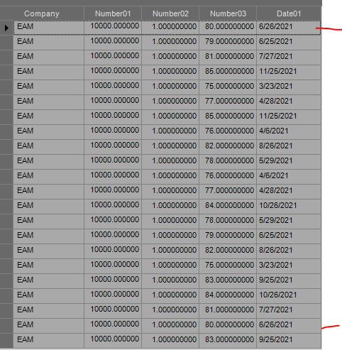

Ive been working on this code a second and I believe I have it working the way I want it to. The code goes through an iterative process to get the order in which the added/updated release was in related to order#, Line, release order. It then iterates through the UD01 Table, that I have set up to grab and hold prior data, and finds its related field to pull a date out of.
The issue is the code used to write the old data to the UD01 table is doubling entries and putting them in out of order. See below pic and code for what I’m working with:

I believe the issue stems from the chunk of code that creates a new guid. I cannot however get that chunk of code to run without erroring out if I do not keep the guid included. Is there a better way of coding this?

Went back to the original code and made a few slight modifications. Now I get the exact results I was after.

Very good, I see you are now setting Key3 to the order rel, probably why you were getting duplicate entries on your earlier code
