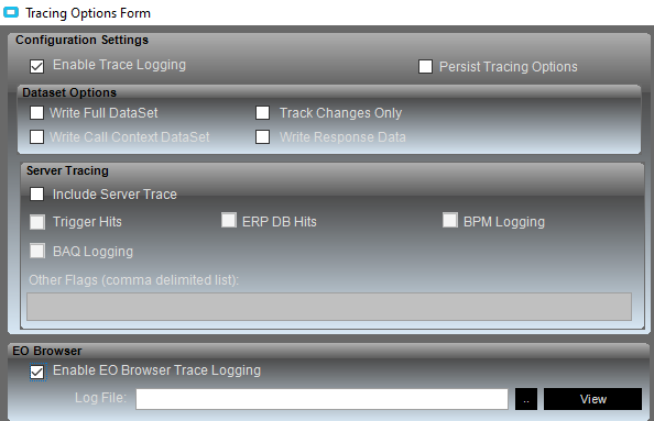

I’m in the process of trying to figure out what specific methods they would be using to update sales order information. I assume it would be a mix of ERP.BO.SalesOrdHedDtlSvc and ERP.BO.SalesOrderSvc. But, I would like to be 100% sure that is the case. In order to figure out which methods they are using, I would like to do a trace while creating a new sales order. Issue is when I run a trace with all settings I seem to get alot of flak and not the specific information I’m after. Could someone help me figure out which specific trace settings to enable?

Well, the BEST way to trace (in my opinion) is to trace one thing at a time. ie…
  1. get into the Process (Order Entry).
  2. Turn on Trace Logging (no datasets yet) and clear the log
  3. press the New Order in order entry
  4. Look at the log file to see what happened… document it… then clear the log
  5. enter your data into the order header and save
  6. do step 4 again… only this time, you will see it calls multiple things. Reason? When you enter a customer, it does things, etc… SOMETIMES, you need to do step 4 after every field, just in case you want to capture that step.
  7. Press new line, then step 4 again
  8. enter part number, check step 4
  9. enter Qty, check step 4
  10. enter price, check step 4
  11. Save, check step 4.
I think when doing it this way, you can narrow down the exact UDMethod you are trying to find.
All that said, you are probably looking for the method SalesOrder.Update which is the method that is used to save any changes to the order.
One more hint for cleaning up the Trace Log: Before you start the Trace, right-click on System Monitor in your system tray and choose Exit, to eliminate the repetitive ReportMonitor calls.
I only select Track Changes Only, and that usually has enough info to figure out what is happening. Then add more checkboxes if needed.

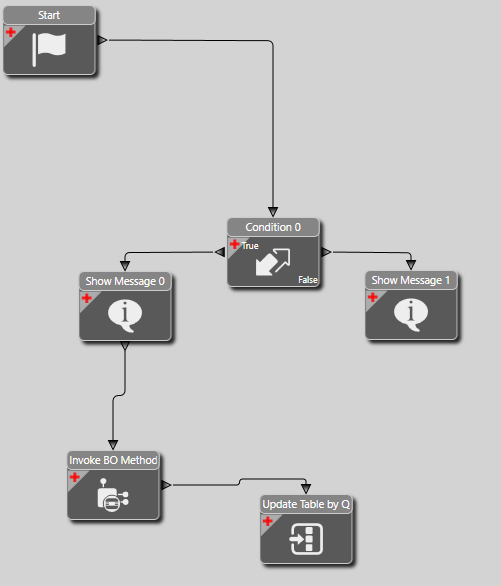

Currently, in the process of creating the first BPM this is the layout I have so far:
The two show message sections are just troubleshooting portions and will be removed when I publish it to our live environment.

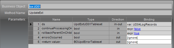

The Invoked BO Method is set up for Ice.UD01.UpdateExt, and is configured as follows:

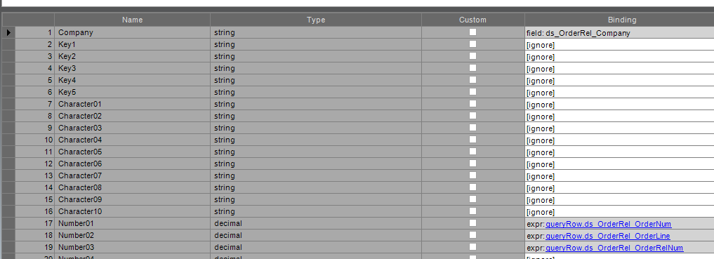

The Update Table by Query is set up using the ds.OrderRel filtered for open releases and displays the company, ordernum, linenum, relnum, and reqdate. It is mapped to UD04LogRecords.UD01 table with the following configuration mapping:

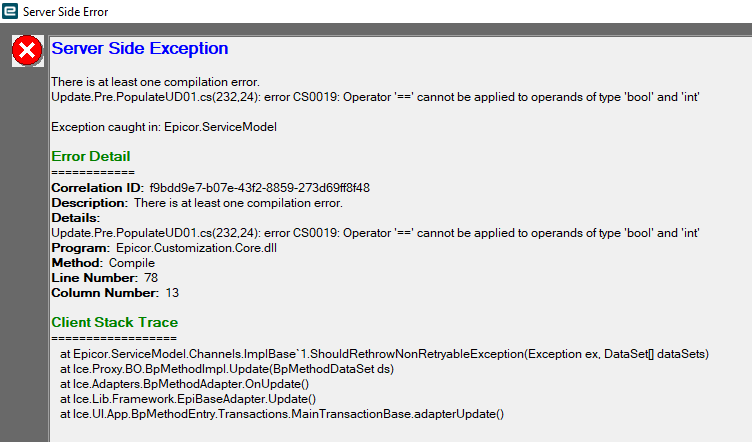

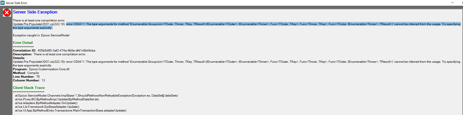

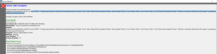

New problem is that what I have built doesn’t seem to be populating the UD table at all. The bpm is a pre process because we need to grab the data before the integration data trickles in. I know there is data to grab as I am able to get the message boxes mentioned prior to populate. Am I missing a step?
Turns out I needed to have the update method after the update table by query widget. After moving those two around I get the following error:
