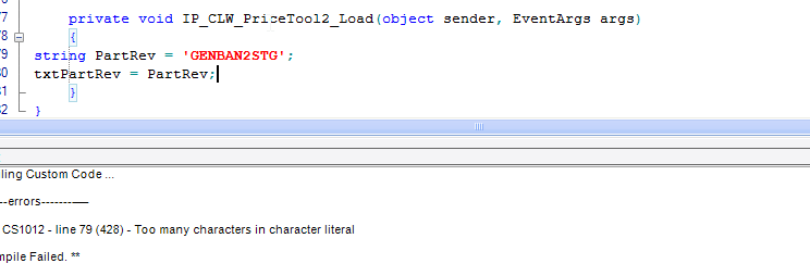

Is there a way I can on load of form populate one field with some text ‘GENBAN2STG’.
Ive tried:
But getting compile errors. Basically I want this text to be filled in automatically when this customisation is loaded and then passed in code to the baq
if you are using TextBox Control.
this.txtPartRev.Text = PartRev;
