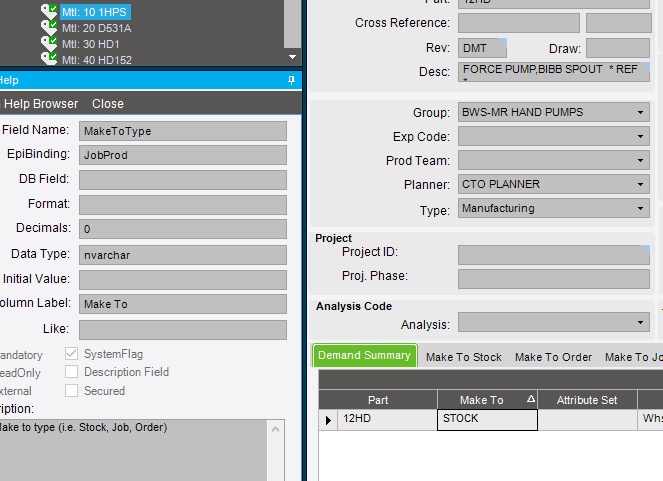

After poking around in the Field Help while looking at the Job Tracker form, I see the following descriptions.
On tab: Job > Make To Stock > field Warehouse. The description reads:
Inventory warehouse that job is producing for.
Only relevant for build to stock demands (ordernum = 0). In this case a valid Part must be referenced.
And on tab: Job > Make to Order field OrderNum. The description reads:
Related sales order number. For build to stock demands the OrderNum, OrderLine and OrderRel fields are all zero
This leads me to believe that your ‘make to stock’ jobs should have 0 in OrderNum,Line and Release. As well as a warehouse filled in. While, ‘make to order’ jobs will have some order number, line number, and release number filled in. The ‘Make to order’ jobs may not have the warehouse filled in. All of these fields are available in JobProd. Does this help get you any closer?

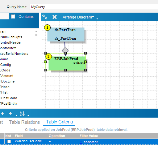

Thank you Nate! That was the answer. I grabbed the Job Prod Table and said if the WaehouseCode = “” then raise the exception.
I overlooked this connection making this way harder than it needed to be! Thanks so much for taking the time to help me out.
