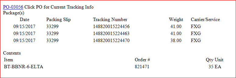

We do a external nightly process ( still in E9 ) that does an email per customer. Two sections Packages and Contents per packnum.
Greg
That’s near the format they want, so good to know there is a way. :wink:

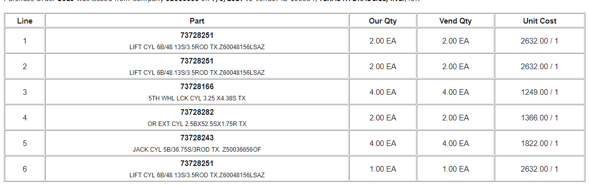

Starter Pack =P Email Template Again - Pulling the Company Settings · GitHub
Thanks @hkeric.wci. This will give me some good help.
It should atleast help you with the HTML Table =) you can always improve upon it. It also uses the Email Address and Name from the Company Configuration.
