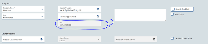

I’ve been using the classic BPM method and data directives. However, quite recently, epicor support attached a screenshot from Kinetic and mentioned that there are some warnings for certain method directives. I inspected those method directives in the classic version and didn’t see any issues or warnings. I’ve been told that BPMs in Kinetic are not trustworthy, but I want to check them out.

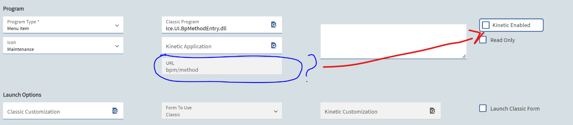

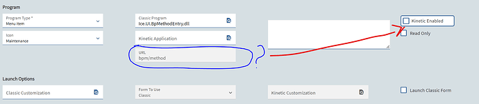

The issue is that I can’t configure the menu item properly to launch BPMs in Kinetic. I believe that in order to launch the form in Kinetic, it must have a URL filled in, I assume, it launches the BE service, but what should that URL be?
For BAQ, it’s studio/baq, but what is the URL for BPMs? I tried some random string (as on the image above) but obviously it didn’t work.
Try: studio/bpm

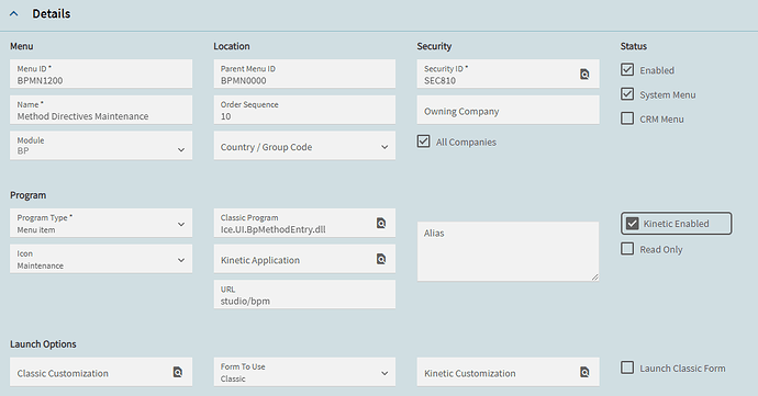

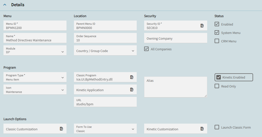

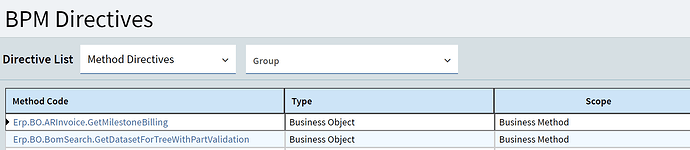

Here’s my menu:
For me… METHOD Directives opens in Classic by default (see above image for “Form to Use”.

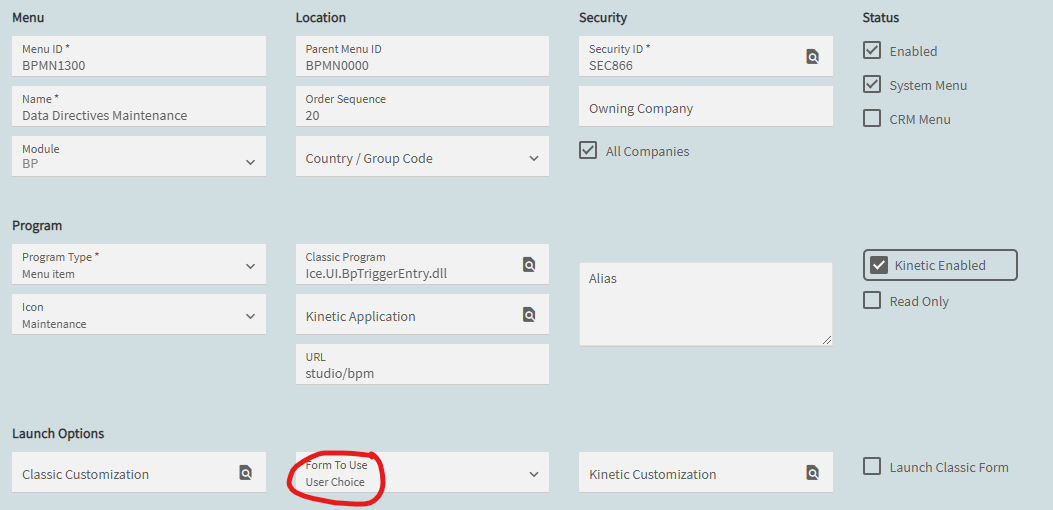

But DATA Directive opens in Kinetic:
All settings are the same except “Form to Use” is set as “User Choice”.
I don’t know what that is based on - they are very similar to BPMs in classic.
Maybe they were intending to say that you can’t expect all your BPMs from classic to work on Kinetic without modification?
yep, works now, thanks:
