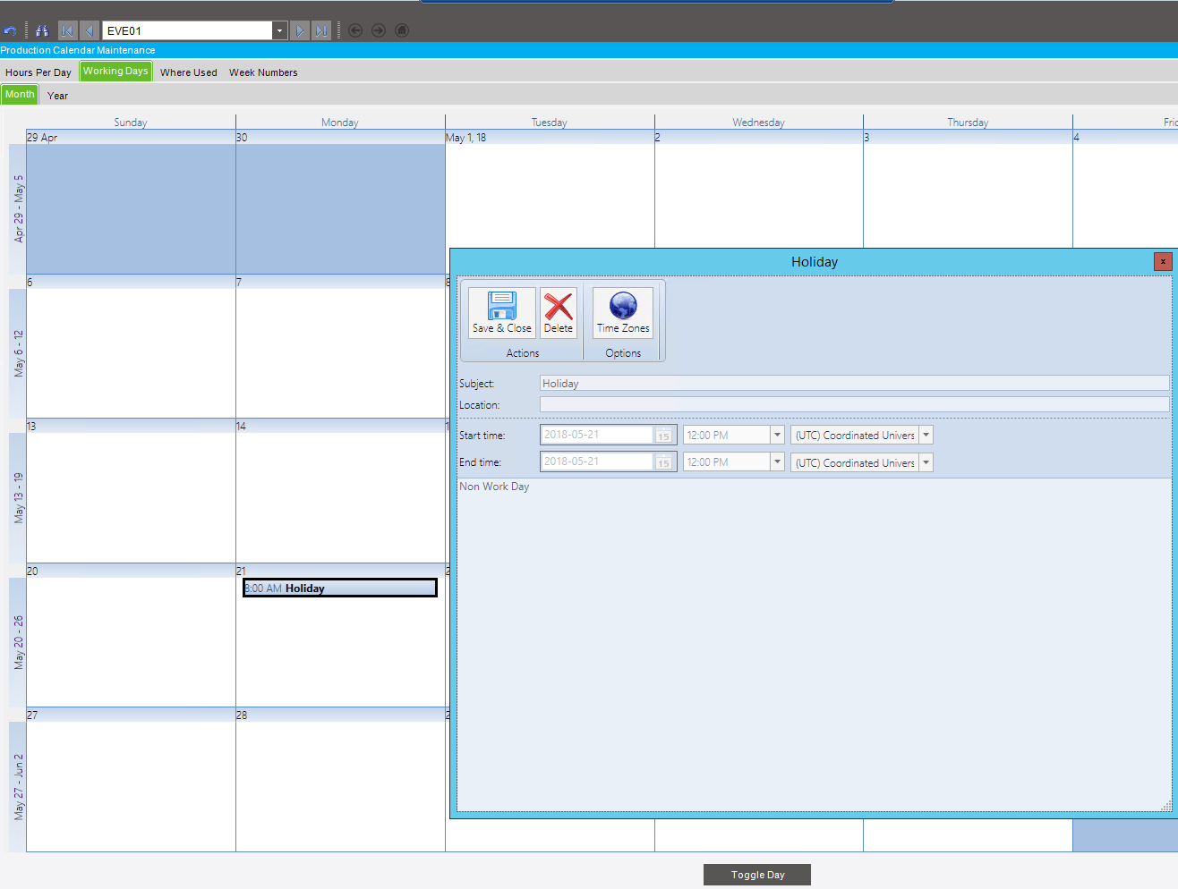

In my production calendar, I entered my holiday. But my code doesn’t take into my holiday in my calendar. In the production calendar, I entered on my toggle day, Holiday.

Have you modified the variable “CalendarToUse” to be the code of your calendar?
for this customer, they always have at least ONE day… so if we are starting on a friday, I know that i need to bump to monday. I am just trying to prevent looping through two extra times.
Yes, I did that, in the variable I indicate my calendar : string CalendarToUse = “EVE01” . But it does not take into consider my holidays
And, you added the holidays into EVE01? The code that I produced did work… it looked through the specified calendar to and skipped holidays as it scrolled through the dates.
in your calendar, the toggle day, what did you enter as name ? My I entered the name Holiday
Thanks.
Hmm… i named it the day of the holiday… but the code doesnt care, it simply is looking to see if it exists.

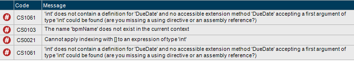

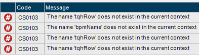

I’m trying to use Haso’s code for a BPM that sets a specific quote task to +2 working days.
@Haso - I’m getting the following errors. What is tqhRow? Do I declare a variable called ‘tqhRow’? Replace ‘tqhRow’ with ‘ttTask’?
I tried creating a tqhRow variable in the variables tab and setting it to int, but then that errors too.
Also, is the ‘bpmName’ at the end supposed to be replaced with my bpm name in quotes (hard coded), or is it supposed to pick it up from the bpm automatically?
Since this thread is 3 years old, and we’re now on 10.2.700 instead of 10.1.500, would other changes apply?
Ultimately I’ll see if I can add this into a function, and then use for other BPM’s with inputs set in the BPM…
Thanks for helping me learn, guys!
