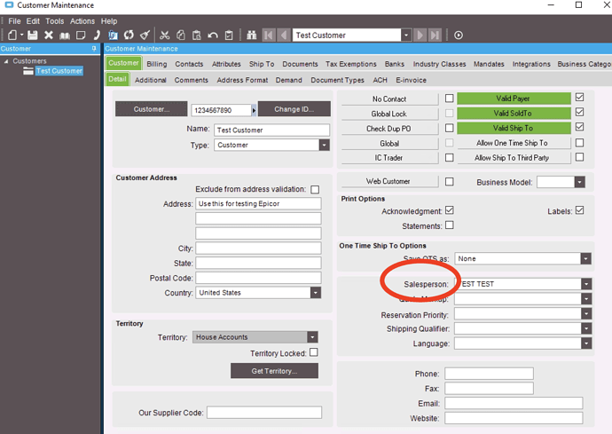

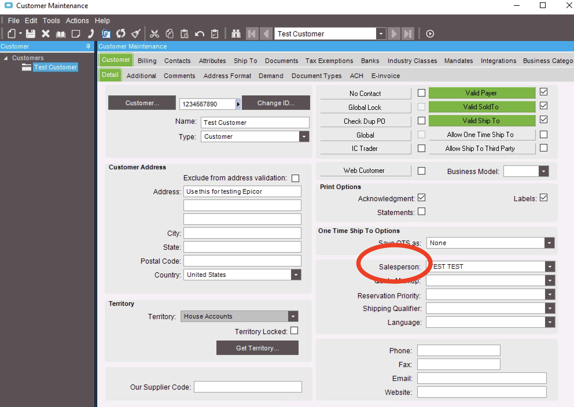

Thank you for that, I will give it a try. I do have a question about the code, it looks like you have it set up to pull multiple sales reps. To my understanding, one customer can only have one Sales Rep here (see below). What is the purpose or function of multiple sales reps – is that something custom you added?
Sorry I misread your original post, but the code will still work fine as it is if there is only one rep, it works for us with only one rep
And no it’s not something custom, there is the ability to add up to 5 reps per sales order…one per customer or shipto address but 5 on the SO
Thank you for clarifying. Learned something new, I never noticed the multiple rep assignment possibilities under Header SalesPersons until you pointed it out just now.
