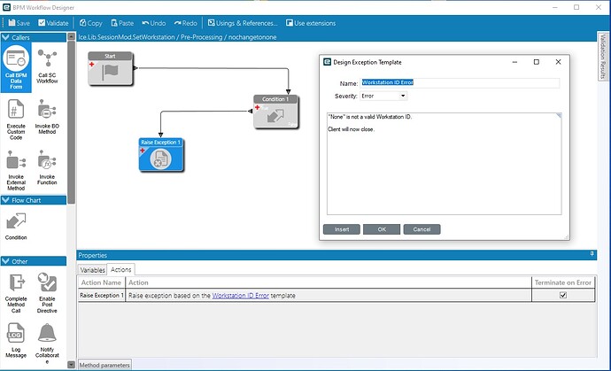

I screwed with it for quite a while.
The best I could do was make the client crash and close when they chose none.
Can display a message before closing though if that’s acceptable.

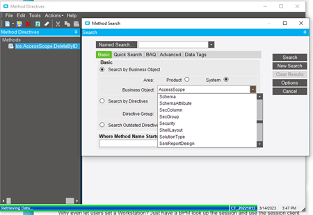

It looks like you’re on Kinetic, Do you know if there is a way to do this in 10.2.600? I can’t even find ice.lib.SessionMod in 10.2.600 to try to create a BPM
Choose ICE, Type Simple Service, then look.
