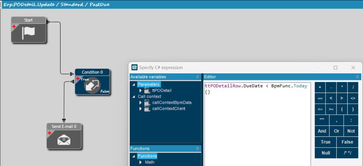

Hi all. I’m looking to create a BPM to send an email from pre-existing dates from PO detail. I want it to send an email to our buyers if a PO line has a due date that is now in the past.
I’ve got the workflow set up right now with a condition stating that if a PO line is open and the due date < today to trigger an email to our buyers. I’ve got it set up with my email right now for testing purposes. The only email that I received for this is a test PO that I purposefully created with a due date in the past.
Is there any way to trigger this email off of pre-existing conditions?
Any help is greatly appreciated!
Why not create a BAQ report? Then send the buyer a daily report of past due items?
Your BPM looks to be set to fire when the record that is past due, is updated.

What steps could I take to trigger the BPM off of the already entered due dates?
That is where the BAQ Report will come in handy. Trying to create a transaction on all records to run your BPM, is not the route to take.

You can go the report route, as others suggested.
If you want to stick to the email route, you can create a scheduled function that collects out of date records and emails them out. Similar to your BPM idea, but you can run it on a schedule rather than waiting for someone to trigger it via a BO method or DB update.
You can also go into SSRS, build a custom report and schedule a subscription.
