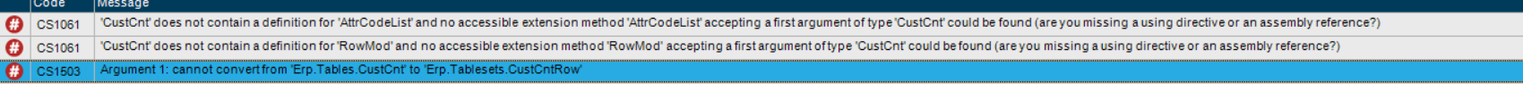

I’m trying to update CustCn and the CustCnAttr table from a UBAQ dataset.
I’m getting a few errors. In the BAQ dataset we are getting the Attr as a comma delimited list

Changed up the code and tried a different angle but no luck…
              using (var custcntclient = Ice.Assemblies.ServiceRenderer.GetService<CustCntSvcContract>(Db))
                        CustCntTableset custcnt = new CustCntTableset();
                        var cnt = Db.CustCnt.Where(r => r.Company == Session.CompanyID && r.WebUserUID_c == row.UD02_WebUserUID_c).FirstOrDefault();
                        if (cnt != null)
                            cnt.FirstName = row.UD02_FirstName_c;
                            cnt.LastName = row.UD02_LastName_c;
                            cnt.PhoneNum = row.UD02_Telephone_c;
                            cnt.AttrCodeList = row.UD02_JobRole_c.Trim(); // Trim the job roles and remove any blank spaces
                            cnt.RowMod = "U";
                            custcnt.CustCnt.Add(cnt);
                            custcntclient.Update(ref custcnt);
Any ideas?

What kind of errors are you experiencing?
Edit–>Nevermind, I see them in the picture.
pull that cnt from the BO, not the Db context.
pass an actual CustCntRow to custcnt.CustCnt.Add();
The row types are not the same.
Would love to see how you would approach this… its quite simple on paper.
I just want to update CustCnt and CustCnAttr from a ubaq… cant get it to work. Makes me angry… :joy:
