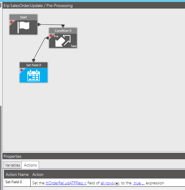

I don’t know if this will work as I haven’t tried it but this can be done with no c# coding
- Post-Proc Method BPM on SO Update (or maybe MasterUpdate) that’ll set the Release checkbox to True if the OH check box is.
Condition would be the standard The (_) field of (the changed row) (is equal to) the (true) expression
Set field would be set similar to this:
