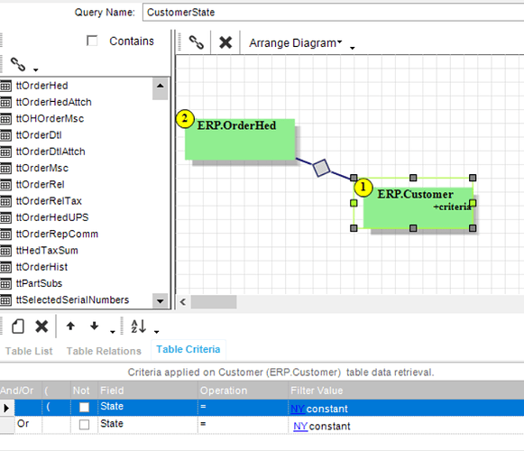

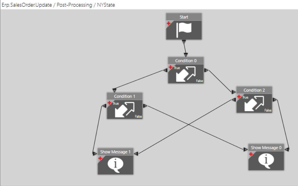

Below are screenshots of my attempt to make a BPM that looks at the state of the ship to address and gives an informational message if the state is NY. I get a compilation error if I try to save.
Also, This Post does almost exactly what I want but I can not get the error message to go away when I try to follow what was done in the post.
Thank you!

> Error CS0103: The name ‘NY’ does not exist in the current context [Update.Post.NYState.cs(122,51)]
> Error CS0103: The name ‘NY’ does not exist in the current context [Update.Post.NYState.cs(123,51)]
> Error CS0103: The name ‘NY’ does not exist in the current context [Update.Post.NYState.cs(167,49)]
> Error CS0103: The name ‘NY’ does not exist in the current context [Update.Post.NYState.cs(168,49)]

You need to make “NY” into a string.
Thank you!
The message box pops up every time the orderhed is updated now but it only gives me the “Yes” message that the state is NY.
How do I get it to display the other message when it is not NY state?
To be honest, your BPM layout is very confusing and not intuitive, so I’m not entirely sure how to answer your question.
Typically, I would have a condition and return one path if the condition was met and another path if the condition was not met. Simplify this BPM and I’m sure you will have better luck.
Here is another observation: your queries are looking at the standard tables and not the temp tables in this BPM. The temp tables will hold context specific data about this record while the standard tables will simply query that table. You might want to change that.
I changed the two orderhed to temp tables and it works perfectly now. Thank you for your help!
